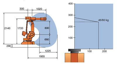

工作范围和载荷图
IRB 4400/45 和4400/60
Working range IRB 4400/45 and 4400/60

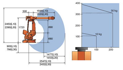

IRB 4400/L10 和4400/L30
Working range IRB 4400/L10 and 4400/L30
