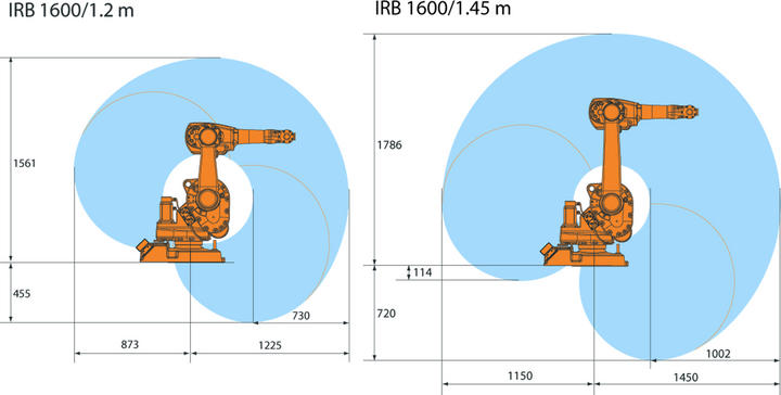

IRB 1600 - 6 / 1.2
6 kg
1.2 m
    铸造专家型二代
IRB 1600 - 6 / 1.45
6 kg
1.45 m
    铸造专家型二代
IRB 1600 - 8.5 / 1.2
8.5 kg
1.2 m
    铸造专家型二代
IRB 1600 - 8.5 / 1.45
8.5 kg
1.45 m
    铸造专家型二代
Working range and load diagram IRB 1600
