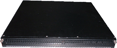

产品名称: 工控机
型  号: Ultra100
品  牌: BESDE
产品介绍: Ultra100w Series
The Ultra100 Series is a high performance design in a low cost 1U rack mount enclosure. Feature rich, the Ultra100 Series is a solid, robust design which will meet the most rigorous and demanding requirements. This chassis is ideal for high density server applications including collocation. The enclosure is constructed of 18 gauge steel, clear zinc plated for corrosion protection and an attractive appearance. The front panel is attractively detailed and is of heavier gauge than the chassis
There is more than ample drive storage. Two drives configurations are possible. One configuration allows one external 5.25 inch drive, external 3.5 inch drive, two internal 3.5 inch drives and an internal 2.5 inch hard drive
The other configuration allows for two external 5.25 inch drives and one external 3.5 inch drive plus an internal 2.5 inch drive. The 2.5 inch drive location is ideal for solid state flash devices
A door covers and protects the drives. Accessible behind the door is the power and reset switches as well as the power-on and drive activity LED's. The LED's are visible through the door when it is closed
Cooling is provided by two fans with a third fan optional. The fans provide tach signals for failure detection by the motherboard
The Ultra100 provides for mounting a standard Backplane
Specification
Feature Description
Dimensions 19" (wide) x 1U (1.7") (high) x 20.5" (deep) Weight - 17 lbs / 8 kgs
Drive Capacity One 5-1/4 inch drive - front accessible One 3-1/2 inch drive - front accessible Two 3-1/2 inch drives -internal One 2-1/2 inch drive - internal - or - Two 5-1/4 inch drives - front accessible One 3-1/2 inch drive - front accessible One 2-1/2 inch drive – internal
Front Panel Controls Power switch - Black momentary rocker with 2 position .100 header for board connection Reset switch - hidden pushbutton with 2 position .100 header for board connection Power LED - green with 3 position .100 header for board connection Drive Activity - Red with 2 position .100 header for board connection Switch and LED connectors are labeled at the connector end
Cooling Two 40mm 8.9CFM fans with tach signal Negative chassis pressure Optional additional 40mm fan
Power Supply AC Input 115/230v – 300W max DC output Zippy RAH and RHH form factor Optional 12, 24 or 48VDC supplies available
Certification CE(EN55022 class B)/FCC(class B)
MTBF: >100000 H
Ambient Temperature Operating temperature test:0~50℃ Non- Operating temperature test:-40~70℃ Non-condensing humidity:10%~95%
