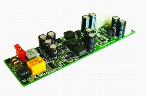

产品名称: 160W ITPS DC/DC车载电源
型  号: 160w
品  牌: hoply
产品介绍: Characteristics
Minimum Input Operating. voltage 6V
Maximum input Operating voltage 24V (clamping will occur at 25-27V)
Deep-Discharge shutdown threshold 11.2V
Input current limit (fuse protected) 15A (15A mini-blade fuse)
Operating temperature -40 to +85* degrees Celsius
Storage temperature -55 to +125 degrees Celsius
MTBF 192,000 hrs @ 50C, 96,000 hrs @65C
Efficiency (Input 9-16V) >94%, all rails combined, 50% load.
size 160x45mm
Input connectors Faston 0.25” terminal
Output Connector ATX Power 20 pin (Molex P/N 39-01-2200)
Output Current (Max) Current Peak
(<60 seconds) Regulation%
5V 8A 12A +/-1.5%
3.3V 8A 12A +/-1.5%
5VSB 1.5A 2A +/-1.5%
-12V 0.15A 0.2A +/-1.5%
12V 8A* (see below) 9A +/-2%
