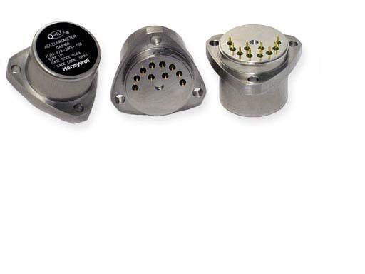

产品名称: HONEYWELL QA-3000高精度加速度计
型  号: QA-3000
价  格: .00
品  牌: HONEYWELL
产品介绍: HONEYWELL QA-3000高精度加速度计
Accelerometer
Highest inertial navigation-grade
performance
For the highest inertial navigation-grade performance available
in today''s market, Honeywell produces the Q-Flex? QA3000.
Built on the same production line as the industry-standard
QA2000 Accelerometer, the QA3000 Accelerometer has the
same inherent quality, reliability, and long-term performance
characteristics of the QA2000 Accelerometer. Primary
applications include spacecraft navigation and control systems.
As with the entire Q-Flex family of accelerometers, the QA3000
features a patented Q-Flex etched-quartz-flexure seismic
system. An amorphous quartz proofmass structure provides
excellent bias, scale factor, and axis alignment stability.
The integral electronics develops an acceleration-proportional
output current providing both static and dynamic acceleration
measurement. By use of a customer supplied output load
resistor, appropriately scaled for the acceleration range of the
application, the output current can be converted into a voltage.
The QA3000 also includes a current-output, internal temperature
sensor. By applying temperature-compensating algorithms, bias,
scale factor, and axis misalignment performance are dramatically
improved.
Features
? Highest performance accelerometer available
? Excellent turn-on repeatability and stability performance
? Environmentally rugged
? Analog output
? Field-adjustable range
? Three fastener precision mounting flange
? Internal temperature sensor for thermal compensation
? Dual built-in test
Configuration Drawings
Performance Characteristics Additional product specifications, outline drawings and block diagrams,
and test data are available on request.
Performance QA3000-030 QA3000-020 QA3000-010
Input Range [g] ±60 ±60 ±60
Bias [mg] <4 <4 <4
One-year Composite repeatability [μg] <40 <80 <125
Temperature Sensitivity [μg/oC] <15 <15 <25
Scale Factor [mA/g] 1.20 to 1.46 1.20 to 1.46 1.20 to 1.46
One-year Composite Repeatability [ppm] <80 <160 <250
Temperature Sensitivity [ppm/oC] <120 <120 <120
Axis Misalignment [μrad] <1000 <1000 <1500
One-year Composite Repeatability [μrad] <70 <80 <100
Vibration Rectification [μg/g2rms] <10 (50-500 Hz) <15 (50-500 Hz) <20 (50-500 Hz)
<35 (500-2000 Hz) <40 (500-2000 Hz) <50 (500-2000 Hz)
Intrinsic Noise [μg-rms] <7 (0-10 Hz)
<70 (10-500 Hz)
<1500 (500-10,000 Hz)
<7 (0-10 Hz)
<70 (10-500 Hz)
<7 (0-10 Hz)
<70 (10-500 Hz)
Environment QA3000-030 QA3000-020 QA3000-010
Operating Temperature Range [oC] -28 to +78 -55 to +95 -55 to +95
Shock [g] 100 150 150
Vibration Peak Sine [g] 15 @ 20-2000 Hz 15 @ 20-2000 Hz 15 @ 20-2000 Hz
Resolution/Threshold [μg] <1 <1 <1
Bandwidth [Hz] >300 >300 >300
Thermal Modeling QA3000-030 QA3000-020 QA3000-010
YES YES YES
Electrical QA3000-030 QA3000-020 QA3000-010
Quiescent Current per Supply [mA] <16 <16 <16
Quiescent Power [mW] @ ±15 VDC <480 <480 <480
Temp Sensor Temp Sensor Temp Sensor
Voltage Self Test Voltage Self Test Voltage Self Test
Current Self Test Current Self Test Current Self Test
Power / Signal Ground Power / Signal Ground Power / Signal Ground
Electrical Interface
-10 VDC Output
+10 VDC Output
-10 VDC Output
+10 VDC Output
-10 VDC Output
+10 VDC Output
Input Voltage [VDC] ±13 to ±28 ±13 to ±28 ±13 to ±28
Physical QA3000-030 QA3000-020 QA3000-010
Weight [grams] 71± 4 71± 4 71± 4
Diameter below mounting surface [inches] ?1.005 Max ?1.005 Max ?1.005 Max
Height - bottom to mounting surface
[inches]
.585 Max .585 Max .585 Max
Case Material 300 Series Stainless Steel 300 Series Stainless Steel 300 Series Stainless Steel
