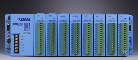

产品名称: 研华数据采集系统,研华PAC,ADAM-5510EKW 8-槽软逻辑控制器
型  号: ADAM-5510EKW
价  格:
品  牌: 研华Advantech
产品介绍: ADAM5000系列模块
产品主要特性:
IEC-61131-3 standard package LD/FB/SFC/IL/ST language Graphical programming interface Cross programming language compiling capability Supports floating point calculation Supports AI/AO/DI/DO/Counter Function Blocks Powerful debug tool Built-in Modbus/RTU Master and Slave Supports up to 128 Local I/O Points Handles typical 32 Modbus/RTU remote I/O modules Supports more than 9000 coils in LD language Supports 3 serial ports including 1 RS-485 and 2 RS-232/485 ports
内容介绍
ADAM-5510EKW is a PC-based SoftLogic Controller. It features 5 standard IEC61131-3 programming languages so PLC users can develop control strategies in their familiar programming languages. The strong MULTIPROG software and stable ProConOS make ADAM-5510EKW the best choice for PC-based SoftLogic controllers in the market. Different from the original ADAM-5510 hardware, the ADAM-5510EKW includes more memory capacity to raise system efficiency and users’ programming flexibility. The main unit of ADAM-5510EKW includes a 1.5 MB flash memory and 640 KB SRAM which includes battery backup RAM up to 32 KB. In addition, 4 COM ports enrich the communication capacity of ADAM-5510EKW to integrate with remote I/O or other 3rd party devices based on the Modbus/RTU protocol. For advanced system integration, the ADAM-5510EKW is built with a Modbus/RTU Server. Therefore, it also supports Modbus/RTU protocol to communicate with any Modbus? device as well as HMI Software/User’s APs built with Modbus driver or Modbus/RTU OPC Server, both of which are included in the SCADA systems.
