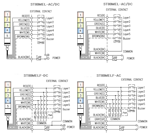

DC ³¤ÁÁÐͲúÆ·
  • DC µçѹ²úÆ· : ºÚÉ«ÏßÁ¬½ÓÔÚ¸º¼«(-)£¬µ«²úÆ·ÄÚ²¿ÓÐÕûÁ÷ÇÅ£¬²úÆ·²»Ó÷ÖÕý¸º¼«¡£
AC³¤ÁÁÐÍ£¬AC/DC ³¤ÁÁ/ÉÁÁÁÐͲúÆ·
  • Òý³ö µçÔ´Ïß ¹æ¸ñ : UL1015-NO.18(0.75sq) x 2c 400mm
    AC µçѹ²úÆ· : ²»Ó÷ֵçÔ´ÏßÑÕÉ«£¬¿ÉÒÔ½»Ìæ½ÓÏß
  • Òý³ö ÐźÅÏß ¹æ¸ñ : UL1007-NO.22 (0.3sq) 400mm
±ê×¼½ÓÏßÒÔÍâ²úÆ·¿ÉÒÔ¶¨×ö¡£

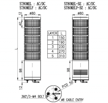

EX)ST80MEL -(BZ) -3 -24 -RAG
ÐͺŠ·äÃùÆ÷ ¶ÎÊý µçѹ ÑÕÉ«
          ST80MEL
          ST80MELF
          ÎÞÖ¸¶¨(None)
     ±ê×¼ÐÍ
     BZÖ¸¶¨(Order)
     ÄÚ×°·äÃùÆ÷ÐÍ
               1-1²ã
               2-2²ã
               3-3²ã
               4-4²ã
               5-5²ã
          12-DC12V
          24-DC24V
          110-AC110V
          220-AC220V
               R-ºì
               A-»Æ
               G-ÂÌ
               B-À¶
               W-°×
  • µÆÕÖÑÕÉ«¿ÉÓÉʹÓÃÕßÀ´Ö¸¶¨¡£
  • ACÓÃÿһ½ÚµÄÖ±½ÓµçÔ´Á¬½Ó·½Ê½ÊǶ¨×ö¹æ¸ñ¡£
    (½ÓÏßʱµçÔ´Ï߸úµçѹDC²úÆ·(ST80MEL)ͬÑù£¬²úÆ·µÄ¸ß¶ÈÓб仯)
