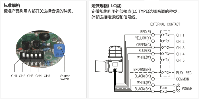

  • ÀûÓÃÔÚ²úÆ·ÄÚ²¿×°µÄÒôµ÷Ñ¡Ôñ¿ª¹ØºÍÒôÁ¿µ÷½ÚÆ÷£¬¿ÉÒÔÑ¡ÔñÒôµ÷¼°µ÷½ÚÒôÁ¿´óС

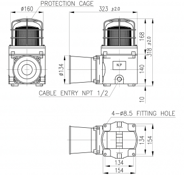

µçÔ´Ïß ÒýÈë¿Ú(CABLE ENTRY)
  • µçÔ´Ïß ´¦Àí : ʹÓ÷À±¬ÌîÁϺ¯
  • µçÔ´Ïß ÒýÈë¿Ú ¹æ¸ñ : NPT 1/2
  • ÒýÈë¿Ú NPT 3/4 ³ß´ç¿ÉÒÔ¶¨×ö¡£
½ÓÏß·½·¨
  • AC µçÔ´²úÆ·£º²»Ó÷ÖÕý¸º¼«¡£
  • DC µçÔ´²úÆ·£ººÚÉ«Ïß¶Ë×ÓÁ¬½ÓÔÚ¸º¼«(-)¡£
