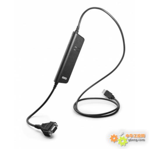

²úÆ·Ãû³Æ£º Kvaser Leaf v3×ÜÏß·ÖÎöÒÇ
ÐÍ ºÅ£º 73-30130-01424-4
Kvaser Leaf v3´ú±íÁ˽«¼ÆËã»úÁ¬½Óµ½CAN×ÜÏßÍøÂçÒÔ¼à¿ØºÍ´«ÊäCANºÍCAN FDÊý¾ÝµÄ×î¼òµ¥¡¢³É±¾×îµÍµÄ·½·¨Ö®Ò»¡£Æ¾½èÆä±ê×¼USB 2.0Á¬½ÓÆ÷ºÍ9ÕëD-SUBÁ¬½ÓÆ÷£¬Leaf Light HS v3ʱÉС¢·ûºÏÈËÌ幤³ÌѧÉè¼ÆµÄÍâ¿Ç¼È×ã¹»¼á¹Ì£¬ÊʺÏÈÕ³£Ê¹Óã¬ÓÖ×㹻СÇÉÁé»î£¬¿ÉÓÃÓÚ¿Õ¼äÊÜÏÞµÄÓ¦Óá£
Leaf v3ÿÃë¿É´¦Àí¶à´ï20000ÌõÏûÏ¢£¬Ê±¼ä´Á¾«¶ÈΪ50΢Ãë¡£²»ÐèÒªÍⲿµçÔ´£¬µçÁ÷¸ôÀëÊDZê×¼ÅäÖá£
Ö÷ÒªÌØµã
•USB CAN½Ó¿Ú¡£
•ͨ¹ýUSBÀàÐ͵ēA”Á¬½ÓÆ÷¹©µç¡£
•Ö§³ÖCAN FD£¬×î¸ß¿É´ï8 Mbit/s¡£
•¿ìËÙ·½±ãµÄ¼´²å¼´Óð²×°¡£
•Ö§³Ö11루CAN 2.0A£©ºÍ29루CAN 2.0B¼¤»î£©±êʶ·û¡£
•Ö§³Ö·ÖÎö¹¤¾ßµÄ¾²Òôģʽ——ÔÚ²»¸ÉÈŵÄÇé¿öÏÂÊÕÌý×ÜÏß¡£
•20000¸öÏûÏ¢/Ã룬ÿ¸öʱ¼ä´ÁÓÐ50μsµÄ·Ö±æÂÊ¡£
•ʹÓÃKvaser CANlibÓëΪÆäËûKvaser CANÓ²¼þ±àдµÄÓ¦ÓóÌÐòÍêÈ«¼æÈÝ¡£
•Ö§³ÖSocketCAN¡£
•ÍêÈ«¼æÈÝJ1939¡¢CANopen¡¢NMEA 2000 R®ºÍDeviceNet¡£
•Ö§³ÖͬʱʹÓöà¸öKvaser½Ó¿Ú¡£
Èí¼þ
Îĵµ¡¢Kvaser CANlib SDKºÍÇý¶¯³ÌÐò¿ÉÁªÏµÏúÊÛ´ú±íÃâ·Ñ»ñÈ¡¡£
Kvaser CANlib SDKÊÇÒ»¸öÃâ·Ñ×ÊÔ´£¬°üÀ¨ÎªKvaser CAN½Ó¿Ú¿ª·¢Èí¼þËùÐèµÄÒ»ÇС£°üÀ¨ÍêÕûµÄÎĵµºÍÐí¶à³ÌÐòʾÀý£¬Ê¹ÓÃC¡¢C++¡¢C#¡¢Delphi¡¢Visual Basic¡¢PythonºÍt±à³ÌÓïÑÔ±àд¡£
Kvaser CANÓ²¼þÊÇÎ§ÈÆÏàͬµÄͨÓÃÈí¼þAPI¹¹½¨µÄ¡£Ê¹ÓÃÒ»ÖÖÉ豸ÀàÐÍ¿ª·¢µÄÓ¦ÓóÌÐò½«ÔÚ²»ÐÞ¸ÄÆäËûÉ豸ÀàÐ͵ÄÇé¿öÏÂÔËÐС£
±£ÐÞ
1Äê±£ÐÞÆÚ¡£Çë²ÎÔÄͨÓÃÌõ¿îºÍÕþ²ß¡£
¼¼Êõ²ÎÊý
CANͨµÀ 1
CAN±ÈÌØÂÊ 20 kbit/s to 1 Mbit/s
CAN FD±ÈÌØÂÊ Up to 8 Mbit/s
CANÊÕ·¢Æ÷ MCP2561FD
ÈÏÖ¤ CE, RoHS
Á¬½ÓÆ÷ 9-pin D-SUB
³ß´ç 35 x 165 x 17 mm
´íÎóÖ¡¼ì²â Yes
´íÎóÖ¡Éú³É NO
µçÁ÷¸ôÀë Yes
¹¤×÷ϵͳ Windows, Linux
¹¤×÷ÎÂ¶È −20 °C to +70 °C
¹¦ºÄ Typical 100 mA
¾²Ä¬Ä£Ê½ Yes
ʱ¼ä´Á·Ö±æÂÊ 50 μs
ÖØÁ¿ 110 g
