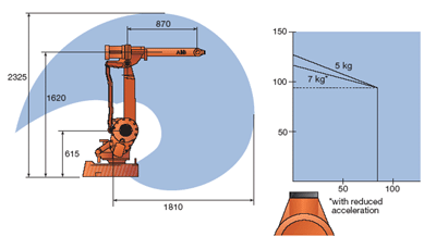

工作范围和载荷图
IRB 2400L
Working range IRB 2400L

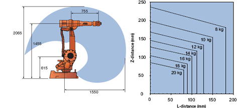

IRB 2400/10, IRB 2400/16
IRB 2400 working range
