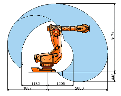

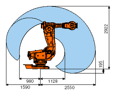

工作范围
IRB 7600-400/2.55 and IRB 7600-500/2.55
IRB 7600-340/2.80
IRB 7600-150/3.50
IRB 7600-340/2.80
IRB 7600-150/3.50
