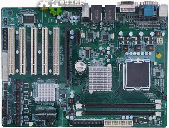

   艾讯宏达即将推出一款采用英特尔G41芯片组的ATX主板SYM76941VGGA。SYM76941VGGA采用Socket   LGA775架构,支持英特尔酷睿4核/酷睿2双核/奔腾D/赛扬D处理器。采用英特尔G41+ICH7(或ICH7R)芯片组,最大支持8GB DDR3 内存。集成2个英特尔82574E PCI-E千兆网络控制器,6个RS232串口,8个USB2.0接口;支持1 个 PCI-EX16, 1个 PCI-EX1, 5 个 PCI扩展槽。
  详细规格:
  >> System
  Processor                            Socekt LGA775 Support Core 2 Quad Q9000 Series/Core 2 Duo/ Pentium D/Celeron D
  Chipset                                Intel G41 + ICH7/ ICH7R(option by MOQ), FSB 800/1066/1333MHz
  DRAM                                  2 x 240PIN DIMM DDR3 800/1066 max up to 8GB
  BIOS                                   8Mb AMI Flash ROM
  Power Supply                       1 x 24Pin ATX power connector, support AT/ATX mode
  Watchdog                            Watchdog timer function (Reset: 1~65535 level)
  Dimension                             305mm x 244mm
  >> I/O Ports
  HDD                                    4 x SATA-300 Interface, support RAID 0/1/5/10(ICH7R)
  FDD                                     1 x FDD port
  Serial Port                             6 x RS232 COM ports
  Parallel                                  1 x Parallel pin-header
  Audio                                   Realtek ALC662 HD audio codec, support 5.1CH audio
  Keyboard/Mouse                    2 x PS/2 for Keyboard and Mouse
  LAN                                     2 x Intel 82574L PCI-E Gigabit Lan
  USB                                     8 x USB2.0 (4 by onboard header)
  Digital I/O                             4 input; 4 output
  Expansion                             1 x PCIeX16, 1 x PCIeX1, 5 x PCI slots Expansion
  >> Display
  Graphics                               Intel GMA X4500, Max. shared system memory up to 1759MB
  VGA                                    2048 x 1536 maximum resolution
  DVI                                     2048 x 1536 maximum resolution
  >> Environment
  Operation Temperature          0°~60°C
  Humidity                              10~90%
