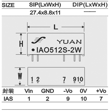

产品详情: ●输出功率(W):0.2/0.5/0.75/1/2/3/4
●标称输入电压(V):3.3/5/9/12/15/ 24
●标称输出电压(V):±5/±9/±12/±15/±24
●隔离电压:1000VAC ,输出精度:< ±2%
●10Pin SIP阻燃封装
●纹波/噪声(20MHZ带宽)<20mVp-p
产品型号举例 输入电压范围 输出电压 输出电流 效率
IA0505S-W5   4.75-5.25VDC ±5VDC  ±50mA  69%
IA0505S-1W   4.75-5.25VDC ±5VDC  ±100mA  72%
IA1212S-1W   11.4-12.6VDC ±12VDC  ±42mA  76%
IA2415S-1W   22.8-25.2VDC ±15VDC  ±33mA   78%
IA0512S-2W   4.75-5.25VDC ±12VDC  ±84mA   77%
IA2415S-2W   22.8-25.2VDC ±15DC  ±67mA   83%
IA2415S-3W   22.8-25.2VDC ±15VDC  ±100mA  81%
