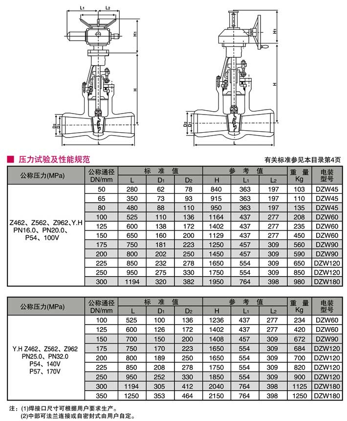

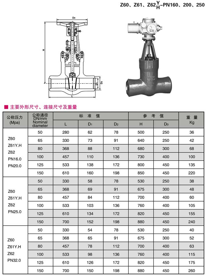

²úÆ·Ãû³Æ£º º¸½ÓÕ¢·§
ÐÍ ºÅ£º Z60Y¡¢Z61Y¡¢Z62Y
Æ· ÅÆ£º 10122
º¸½ÓÕ¢·§ÊÊÓÃÓÚ¹«³ÆÑ¹Á¦16£®0¡ª32£®0Mpa£¬¹¤×÷ζȡÜ540¡æ(ÆäÖÐP57170V_T_×÷ζȡÜ570¡æ)µÄʯÓÍ¡¢»¯¹¤¡¢»ðÁ¦µçÕ¾µÈ¸÷ÖÖ¹¤¿öµÄ¹Ü·ÉÏ£¬Çжϻò½Óͨ½éÖÊ¡£ÊÊÓýéÖÊΪ£ºË®¡¢ÓÍÆ·¡¢ÕôÆûËáÐÔ½éÖʵȡ£²Ù×÷·½Ê½ÓУºÊÖ¶¯¡¢³ÝÂÖ´«¶¯¡¢µç¶¯µÈ¡£
¸ßθßѹº¸½ÓÕ¢·§µÄÖ÷ÒªÓŵ㣺
(1)Á÷Ìå×èÁ¦Ð¡¡£Õ¢·§Õ¢ÌåÄÚ²¿½éÖÊͨµÀÊÇֱͨµÄ£¬½éÖÊÁ÷¾­Õ¢·§Ê±²»¸Ä±äÆäÁ÷¶¯·½Ïò£¬Òò¶øÁ÷¶¯×èÁ¦½ÏС¡£
  (2)Æô±Õ½ÏÊ¡Á¦¡£Æô±Õʱբ°åÔ˶¯·½ÏòÓë½éÖÊÁ÷¶¯·½ÏòÏà´¹Ö±¡£Óë½ØÖ¹·§Ïà±È£¬Õ¢·§µÄÆô±Õ½ÏΪʡÁ¦¡£
  (3)½éÖÊÁ÷¶¯·½ÏòÒ»°ã²»ÊÜÏÞÖÆ¡£½éÖʿɴÓÕ¢·§Á½²àÈÎÒâ·½ÏòÁ÷¹ý£¬¾ùÄÜ´ïµ½½Óͨ»ò½Ø¶ÏµÄÄ¿µÄ¡£±ã×Ó°²×°£¬ÊÊÓÃÓÚ½éÖʵÄÁ÷¶¯·½Ïò¿ÉÄܸıäµÄ¹Ü·ÖС£
¸ßθßѹº¸½ÓÕ¢·§¹¤×÷Ô­Àí£º
       Éè¼ÆÖÆÔì°´JB£¯T3395µÈ±ê×¼£¬¿ÉÓë¹ú²úÉ豸ÅäÌ×ʹÓ᣸ßθßѹº¸½ÓÕ¢·§ÖÐÇ»²ÉÓÃѹÁ¦×Ô½ôʽÃÜ·â½á¹¹£¬ÄÚǻѹÁ¦Ô½¸ßÃÜ·âÐÔÄÜÔ½ºÃ¡£Ö§¹ÜÁ½¶ËΪº¸½Ó½á¹¹£¬ÊÊÓ¦²»Í¬µÄ½Ó¹ÜÒªÇó¡£Õ¢°åºÍ·§×ùµÄÃÜ·âÃæ²ÉÓÃ˾̫Á¢(stellite)îÜ»ùÓ²ÖʺϽð¶Ñº¸¶ø³É£¬ÄÍÄ¥¡¢Ä͸ßΣ¬Ä͸¯Ê´£¬¿¹²ÁÉËÐÔÄܺ᣷§¸Ë¾­µ÷ÖʺͱíÃæµª»¯´¦Àí£¬ÓÐÁ¼ºÃµÄ¿¹¸¯Ê´ÐԺͿ¹²ÁÉËÐÔ¡£Æô±Õ¼þµÄ½á¹¹¿É¸ù¾ÝÓû§ÒªÇóÉè¼Æ³Éµ¥°å¡¢Ë«°å¡¢Æ½ÐÐË«°åµÈ²»Í¬ÐÎʽ¡£
