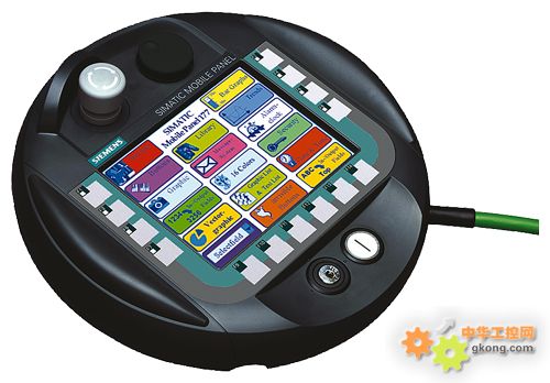

6AV6645-0DE01-0AX1
SIMATIC HMI, 移动面板 277 IWLAN V2,7.5 寸,64 K 色,键控 + 触摸,18 功能键(18 个 LED),无线以太网(PROFINET)通讯, 手轮、钥匙开关和 2 个照明按钮
技术数据
SIMATIC MOBILE PANEL 277 IWLAN V2, WITH HANDWHEEL, KEY SWITCH AND TWO ILLUMINATED PUSHBUTTON, CONFIGURABLE W. WINCC FLEXIBLE STANDARD VERSION 2008 AND HIGHER OR TIA PORTAL V11 SP2 AND HIGHER INCL. 1 MAIN BATTERY POWER SUPPLY TO BE ORDERED SEPARATELY: 6AV6671-5CE00-0AX1 CHARGING ST. 6AV6671-5CN00-0AX2 EXTERNAL POWER SUPPLY UNIT (EU/US/UK/JP) |
