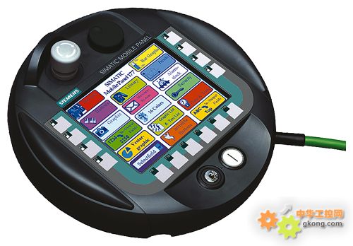

6AV6645-0EC01-0AX1
SIMATIC HMI, 移动面板 277F IWLAN V2,7.5 寸,64 K 色,键控 + 触摸,18 功能键(18 个 LED),无线以太网(PROFINET)通讯,使能和急停按 钮,手轮、钥匙开关和 2 个照明按钮
技术数据
SIMATIC MOBILE PANEL 277F IWLAN V2, WITH INTEGRATED ENABLING- EMERGENCY-STOP BUTTON, HANDWHEEL, KEY SWITCH AND TWO ILLUMINATED PUSHBUTTONS, SUPPORTING IPCF (RAPID ROAMING) CONFIGURABLE W. WINCC FLEXIBLE STANDARD WITH VERSION 2008 SP 2 INCL. 1 MAIN BATTERY POWER SUPPLY TO BE ORDERED SEPARATELY: 6AV6671-5CE00-0AX1 CHARGING ST. 6AV6671-5CN00-0AX2 EXTERNAL POWER SUPPLY UNIT (EU/US/UK/JP) |
