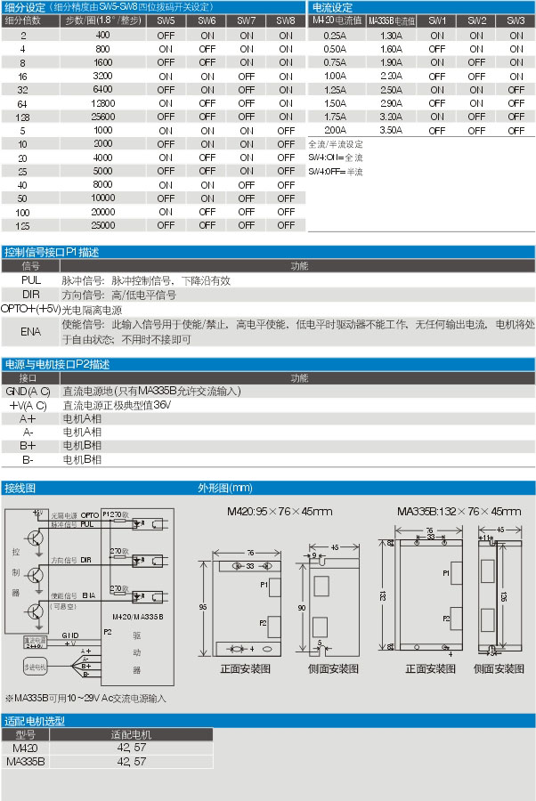

Ë«¼«ºãÁ÷Õ¶²¨·½Ê½
¹©µçµçѹ×î¸ß´ï40VDC»ò29VAC
×î´óÇý¶¯µçÁ÷2.0A(M420)£»3.5A(MA335B)
ϸ·Ö¾«¶È128±¶Ï¸·Ö¿ÉÑ¡
20KHzÕ¶²¨ÆµÂÊ
¾²Ö¹Ê±µçÁ÷¿É×Ô¶¯¼õ°ë
¹â¸ôÀëÐźÅÊäÈë
²ÉÓÃÔ­×°½ø¿Ú½ÓÏß¶Ë×Ó£¬²¦²å·½±ãʵÓÃ
