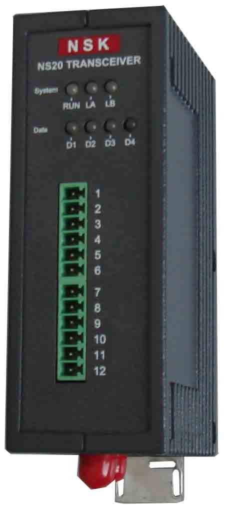

²úÆ·Ãû³Æ£º NS20Êý¾Ý¹âÏËÊÕ·¢Æ÷
ÐÍ ºÅ£º NS2001,NS2002,NS2003
Æ· ÅÆ£º NSK
Ö÷ÒªÌØµãÓëÓÅÊÆ
Ÿ    ½Ó¿ÚËÙÂÊ£º0-115.2Kbps; Ïß·ËÙÂÊ×ÔÊÊÓ¦
Ÿ    ½Ó¿ÚÀàÐÍ£º3·RS232 + 1 ·RS485 »ò 2·RS232 + 1 ·RS422 »ò  4·RS232½Ó¿Ú
Ÿ    ´«ÊäÀàÐÍ£º¶ÔÒµÎñµÄ͸Ã÷´«Êä
Ÿ    ¹â¿ÚÐÎʽ£ºFC¡¢SC, FCÊÕ·¢µ¥Ð¾¹âÏ˽ÓÍ·;SCÊÕ·¢µ¥Ð¾¹âÏ˽ÓÍ·
Ÿ    ·¢¹â¹¦ÂÊ£º£¾-13dbm£¨µ¥Ä£ÏµÍ³£©   £¬£¾-20dbm£¨¶àģϵͳ£©
Ÿ    ÊÕ¹âÁéÃô¶È£º£¼-28dbm£¨µ¥Ä£ÏµÍ³£©£¬£¼-34dbm£¨¶àģϵͳ£©
Ÿ    ´«Êä¾àÀ룺µ¥Ä££¬0km ~ 35km,³¤¾àÀë¿É´ï120km£» ¶àÄ££¬0km ~ 2.5km
Ÿ    Êý¾Ý½Ó¿Ú£º2¸ö6Ïß½ÓÏß¶Ë×Ó
&#376;    ÊäÈëµçÔ´£ºDC9V-DC30V »ò AC85-250V »ò DC100V-DC300V£¬ < 1W £»
&#376;    LED״̬£º¹â¿ÚÏß·£¬Êý¾Ý¿Ú¡¢µçԴָʾ¡¢ÔËÐÐָʾ
&#376;    ¸æ¾¯Êä³ö£º¼ÌµçÆ÷½Ó¿Ú£¬24V@1A,125VAC@0.2A,¿Éָʾ¶Ô¶Ë״̬,¿ÉÓÃÓÚ¹¤ÒµÏÖ³¡×é̬
&#376;    »ú¿Ç½á¹¹£ºD35mmµ¼¹ìʽ£¬40x 110 x 74£¨mm£©
&#376;    »ú¿Ç¹¤ÒÕ£º½ðÊôÖýÔ죻·À»¤µÈ¼¶£ºIP40
&#376;    Õñ¶¯ÌØÐÔ£º·ûºÏIEC68-2-6
&#376;    ÖØ    Á¿£ºÔ¼500g
&#376;    ÎÂÊªÌØÐÔ£º¹¤×÷ζȣ¬-35¡æ ~ +75¡æ£»Êª¶È£º95%ÎÞÄý¶£»
&#376;    ´æÖüζȣº-45¡æ ~ +85¡æ
&#376;    µç´Å¼æÈÝ£º   EN61000-4-2£¨8KV»ú¿Ç¾²µç£©
EN61000-4-3£¬ENV50204£¨¿¹µç´Å¸ÉÈÅ10V/mÔÚ10KHz-1GHz£©
EN61000-4-4£¨2KV¿ìËÙÂö³åȺ£©
EN61000-4-5£¨¹²Ä£1KV£¬²îÄ£2KVÀËÓ¿£©
EN55022£¨·øÉä·ûºÏ class B£©
ÐͺÅ
¹¦  ÄÜ  Ãè  Êö
NS2001
3·RS232½Ó¿Ú + 1·RS485½Ó¿Ú,Á½ÖÖÊý¾Ý½Ó¿Ú¾ù¿É´ï×î¸ßËÙÂÊ115.2Kbps£¬D35mm¿¨¹ìʽ°²×°£»IP40·À»¤µÈ¼¶µÄÖýÔì»ú¿Ç£»3.81mm¼ä¾à¶Ë×ÓÅÅÁ¬½Ó·½Ê½£¬Ë«ÈßÓàDC9-30VµçÔ´£¬¼ÌµçÆ÷¸æ¾¯Êä³ö£¬ÄÚÈݷḻµÄLEDָʾµÆÏÔʾ¡£
NS2002
¶Ô¹¦ÄܵÈNS2001£¬²»Í¬ÊÇËùÓÐÊý¾Ý½Ó¿ÚÓÐ4·RS232½Ó¿Ú
NS2003
¶Ô¹¦ÄܵÈNS2001£¬²»Í¬ÊÇËùÓÐÊý¾Ý½Ó¿ÚÓÐ2·RS232½Ó¿Ú + 1·RS485
 NS2004 ¶Ô¹¦ÄܵÈNS2001£¬µçԴΪAC85V-250V»òDC100V-300V
  NS2005
 ¶Ô¹¦ÄܵÈNS2002£¬µçԴΪAC85V-250V»òDC100V-300V
NS2006
¶Ô¹¦ÄܵÈNS2003£¬µçԴΪAC85V-250V»òDC100V-300V
