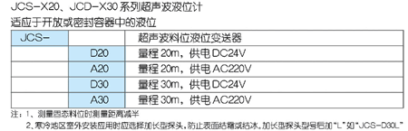

JCSϵÁг¬Éù²¨Îïλ£¨ÒºÎ»¡¢ÁÏ룩±äËÍÆ÷£¬²ÉÓòâÁ¿Ê±¼ä²îµÄÔÀí£¬²âµÃÎïÁϸ߶ȡ£¸Ã²úƷΪ·Ç½Ó´¥²âÁ¿ÒÇ±í£¬ÓкÜÇ¿µÄ¿¹¸ÉÈÅÄÜÁ¦£¬°²×°¡¢Î¬»¤¡¢Ê¹Ó÷dz£·½±ã£¬¸üÊʺÏÓÚ»·¾³¸´ÔӵĹ¤ÒµÏÖ³¡¡£Ëü²ÉÓÃС¹¦ÂÊ¡¢Ð¡Ã¤ÇøÊÕ·¢ÐÍרÓó¬Éù²¨´«¸ÐÆ÷£¬²âÁ¿¾«¶È¸ß£¬ÔËÐÐÎȶ¨£¬¾ßÓÐζȲ¹³¥¹¦ÄÜ¡£¿É¹ã·ºÓÃÓÚµçÁ¦¡¢Ò±½ð¡¢½¨²Ä¡¢»¯¹¤¡¢Á¸Ê³µÈÐÐÒµ£¬¼È¿É²âÁ¿ÒºÌåÎïÁÏ£¬Ò²¿É²âÁ¿¹ÌÌåÎïÁÏ¡£
ÊäÈë
²âÁ¿·¶Î§£º
20m 0.8¡«20m
30m 1.2~30m
Êä³ö£º
mA 4¡«20mA
¾«¶È£º ʵ¼ÊÁ¿³Ì0.2£¥£¨¿ÕÆøÖУ©
²âÁ¿·¶Î§£ºÕý±È»ò·´±È
×î´ó¸ººÉ£º24VDC 500
¹©µç£º
JCS-DXX DC24V(¡À10%) 0.1A
JCS-AXX AC220V(¡À20%)0.1A
¼ÌµçÆ÷¹æ¸ñ£º
5A¡¢AV250V»ò DC30V
¾«¶È£º
²âÁ¿Îó²î£ºÂúÁ¿³ÌµÄ0.2£¥£¨¿ÕÆøÖУ©
·Ö ±æ ÂÊ£ºÂúÁ¿³ÌµÄ0.03£¥
ζȲ¹³¥£ºÄÚÖÃ
¶î¶¨²Ù×÷Ìõ¼þ
²¨Êø½Ç£º 5¡ã£¨3db£©
»·¾³Ìõ¼þ£º
λÖãºÊÒÄÚ/ÊÒÍâ
¸ß¶È£º2000mÒÔÄÚ
×î´óѹÁ¦£ºÕý³£´óÆøÑ¹
»·¾³Î¶ȣº£40¡«£«75¡æ
·À»¤µÈ¼¶£ºÖ÷»úIP67/´«¸ÐÆ÷IP68
°²×°µÈ¼¶£ºII
ÎÛȾµÈ¼¶£º4
·À¸¯µÈ¼¶£ºÆøÌå·À¸¯
