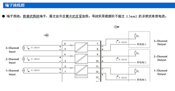

    ÊäÈë½ÓÏß¶Ë 1¡¢2¡¢3¡¢4¡¢5¡¢6
    Êä³ö½ÓÏß¶Ë 7¡¢8¡¢9¡¢10¡¢11¡¢12
    ¹©µçµçÔ´½ÓÏß¶Ë 13£­¡¢14£«
    ÊʺϽØÃæ»ý²»³¬¹ý 2.5mm2 µÄ¶à¹É»òµ¥¹ÉµçÀ¡£
