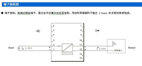

1. ÊäÈë½ÓÏß¶Ë
  ÂÌÉ«±êʶ£¬Á¬½ÓÖÁÏÖ³¡É豸
2. µçԴָʾµÆ£º
  ÒDZíͨµç»ò´¦ÓÚÕý³£¹¤×÷״̬ʱµÆÁÁ
3. Êä³ö½ÓÏß¶Ë
  ÂÌÉ«±êʶ£¬Á¬½ÓÖÁ¿ØÖÆÏµÍ³»òÆäËüµ¥Ôª×éºÏÒDZí
4. ×ó²à»ú¿Ç¸Ç
  ÓëÒDZíÓÒÃæ»ú¿Ç½ôÃܿۺϣ¬ÓúÏÊʹ¤¾ß¿ÉÇË¿ª
5. µçÔ´½ÓÏß¶Ë
  2¿× 3mm ¹©µçµçÔ´½ÓÏß £¨13-/14+£©
6. Í¸ÆøÉ¢ÈÈ¿×
  Ãܼ¯É¢Èȿף¬Í¨·ç¶ÔÁ÷Éè¼Æ
7. ²úÆ·±êǩճÌù²¿Î»
  PETÄÍÈȲÄÖʱêÇ©£¬±ê×¢²úÆ·ÐͺŴúÂë
  ¼°Ïà¹ØÖØÒª²ÎÊý
8. ÓÒ²à»ú¿Ç
  ÎªÖ÷Ìå»ú¿Ç¹¹¼þ£¬Óë×ó»ú¿Ç¸Ç¿ÛºÏ¡£
9. °²×°¿¨¿Ú
  35mm ±ê×¼ DIN µ¼¹ì¿¨Ê½°²×°

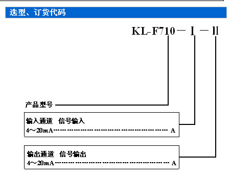

¶©»õÐëÖª£º
1¡¢²ÎÕÕÑ¡Ð;ÙÀý£¬ÕýÈ·¹æ·¶Êéд¶©»õÐͺŴúÂë¡£
¾ÙÀý1£º
ÊäÈ룺4¡«20mA
Êä³ö£º4¡«20mA
    ¶©»õ´úÂëΪ£ºKL-F710-AA
