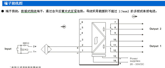

¡ñ  ½ÓÏß¶Ë×Ó
    °Î²åʽ½ÓÏß¶Ë×Ó
    ¶Ë×Ó±êºÅ£º
    ÊäÈë½ÓÏß¶Ë 1¡¢2¡¢3¡¢4¡¢5¡¢6
    Êä³ö½ÓÏß¶Ë 7¡¢8¡¢9¡¢10¡¢11¡¢12
    ¹©µçµçÔ´½ÓÏß¶Ë 13£­¡¢14£«
    ÊʺϽØÃæ»ý²»³¬¹ý 2.5mm2 µÄ¶à¹É»òµ¥¹ÉµçÀ¡£

²úÆ·½á¹¹
¡ñ ½á¹¹
  ¿¨×°Ê½¹¹Ô죻ģ¿é»¯±íо£»ABS ²ÄÖÊ»ú¿Ç£»°Î²åʽ¶Ë×Ó¡£
1. ÊäÈë½ÓÏß¶Ë
  ÂÌÉ«±êʶ£¬Á¬½ÓÖÁÏÖ³¡É豸
2. µçԴָʾµÆ£º
  ÒDZíͨµç»ò´¦ÓÚÕý³£¹¤×÷״̬ʱµÆÁÁ
3. Êä³ö½ÓÏß¶Ë
  ÂÌÉ«±êʶ£¬Á¬½ÓÖÁ¿ØÖÆÏµÍ³»òÆäËüµ¥Ôª×éºÏÒDZí
4. ×ó²à»ú¿Ç¸Ç
  ÓëÒDZíÓÒÃæ»ú¿Ç½ôÃܿۺϣ¬ÓúÏÊʹ¤¾ß¿ÉÇË¿ª
5. µçÔ´½ÓÏß¶Ë
  2¿× 3mm ¹©µçµçÔ´½ÓÏß £¨13-/14+£©
6. Í¸ÆøÉ¢ÈÈ¿×
  Ãܼ¯É¢Èȿף¬Í¨·ç¶ÔÁ÷Éè¼Æ
7. ²úÆ·±êǩճÌù²¿Î»
  PETÄÍÈȲÄÖʱêÇ©£¬±ê×¢²úÆ·ÐͺŴúÂë
  ¼°Ïà¹ØÖØÒª²ÎÊý
8. ÓÒ²à»ú¿Ç
  ÎªÖ÷Ìå»ú¿Ç¹¹¼þ£¬Óë×ó»ú¿Ç¸Ç¿ÛºÏ¡£
9. °²×°¿¨¿Ú
  35mm ±ê×¼ DIN µ¼¹ì¿¨Ê½°²×°
