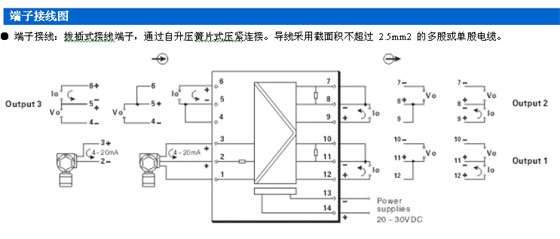

    ÊäÈë½ÓÏß¶Ë 1¡¢2¡¢3¡¢4¡¢5¡¢6
    Êä³ö½ÓÏß¶Ë 7¡¢8¡¢9¡¢10¡¢11¡¢12
    ¹©µçµçÔ´½ÓÏß¶Ë 13£­¡¢14£«
    ÊʺϽØÃæ»ý²»³¬¹ý 2.5mm2 µÄ¶à¹É»òµ¥¹ÉµçÀ¡£

1. ÊäÈë½ÓÏß¶Ë
  ÂÌÉ«±êʶ£¬Á¬½ÓÖÁÏÖ³¡É豸
2. µçԴָʾµÆ£º
  ÒDZíͨµç»ò´¦ÓÚÕý³£¹¤×÷״̬ʱµÆÁÁ
3. Êä³ö½ÓÏß¶Ë
  ÂÌÉ«±êʶ£¬Á¬½ÓÖÁ¿ØÖÆÏµÍ³»òÆäËüµ¥Ôª×éºÏÒDZí
4. ×ó²à»ú¿Ç¸Ç
  ÓëÒDZíÓÒÃæ»ú¿Ç½ôÃܿۺϣ¬ÓúÏÊʹ¤¾ß¿ÉÇË¿ª
5. µçÔ´½ÓÏß¶Ë
  2¿× 3mm ¹©µçµçÔ´½ÓÏß £¨13-/14+£©
