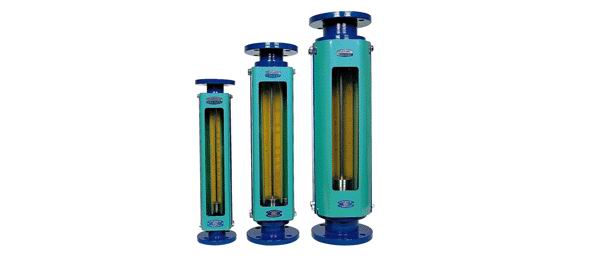

 LZBϵÁв£Á§×ª×ÓÁ÷Á¿¼Æ
      ²£Á§×ª×ÓÁ÷Á¿¼ÆÓÃÓÚ²âÁ¿¹ÜµÀÄÚµ¥Ïà·ÇÂö¶¯ÒºÌå¡¢ÆøÌåµÄ˲ʱÁ÷Á¿¡£Ö÷ÒªÓ¦ÓÃÓÚ»¯¹¤¡¢Ê¯ÓÍ¡¢Ò½Ñ§¡¢»¯·Ê¡¢Ê³Æ·¡¢ÖÆÌÇ¡¢ÔìÖ½¡¢ÇṤ¡¢·ÄÖ¯¡¢Ó¡È¾¡¢»·±£µÈ¹¤Òµ²¿ÃźͿÆÑе¥Î»¡£·À¸¯ÐͲ£Á§×ª×ÓÁ÷Á¿¼ÆÖ÷ÒªÓë½éÖʽӴ¥²¿·Ö²ÉÓþÛËÄ·úÒÒÏ©¸ß¼¶·À¸¯²ÄÁÏ¡£¶Ô¸÷ÖÖÇ¿Ëᣨ³ýÇâ·úËáÍ⣩¡¢Ç¿¼î¡¢Ñõ»¯¼Á¡¢Ç¿Ñõ»¯ÐÔËá¡¢ÓлúÈܼÁ¼°ÆäËûÓи¯Ê´ÐÔÆøÌå¡¢ÒºÌåµÄÁ÷Á¿²âÁ¿ÖУ¬ÓÐÁ¼ºÃµÄÄ͸¯Ê´ÐÔÄÜ¡£ÇëÀ´µç07555£­26411809£¬ÎðÍøÕ¾Ö±½Ó»Ø¸´¡£

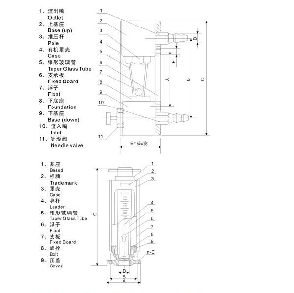

LZB-3¡¢4¡¢6¡¢10µÄÍâÐͼ°°²×°³ß´ç
ÐͺÅ
A
B
C
D
E
F
LZB-3
116
136
§¶8
26¡Á25
LZB-4
178
204
234
§¶9
39.5¡Á34
2-M6
LZB-6
178
204
234
§¶9
39.5¡Á34
2-M6
LZB-10
178
208
238
§¶12
39.5¡Á34
2-M6
LZB-15¡¢25¡¢40¡¢50¡¢80¡¢100ÍâÐÍ£¨ÈçÉÏͼ£©¼°°²×°³ß´ç£¨°üÀ¨F¡¢S¡¢BÐÍ£©
ÐͺÅ
A
B
C
D
n-E
LZB-15
§¶95
§¶65
470¡À2.5
§¶15
4-§¶14
LZB-25
§¶115
§¶85
470¡À2.5
§¶25
4-§¶14
LZB-40
§¶145
§¶110
570¡À3
§¶40
4-§¶18
LZB-50
§¶160
§¶125
570¡À3
§¶50
4-§¶18
LZB-80
§¶185
§¶150
660¡À3.5
§¶80
4-§¶18
LZB-100
§¶205
§¶170
660¡À3.5
§¶100
4-§¶18
×¢£ºLZB£­15ÎÞµ¼¸Ë

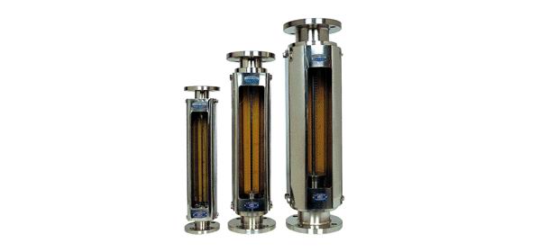

LZB-BÐͲ£Á§×ª×ÓÁ÷Á¿¼Æ
     È«²»Ðâ¸ÖÁ÷Á¿¼Æ¼°»ù×ù¡¢Ö§°å¡¢ÕÖ¿Ç¡¢µ¼¸Ë¡¢¸¡×ÓÒÔ¼°¹Ì¶¨ÂÝË¿¾ùΪ²»Ðâ¸Ö²ÄÖÊ¡£ÆäÍâÐÍÃÀ¹Û£¬Çå½à¹âÁÁ£¬²¢ÇÒ¾ßÓÐÒ»¶¨µÄÄ͸¯Ê´ÐÔ£¬ÊÇʳƷ¡¢Ò½ÁÆ¡¢»¯¹¤ÐÐÒµµÄÀíÏëÓÃÆ·¡£

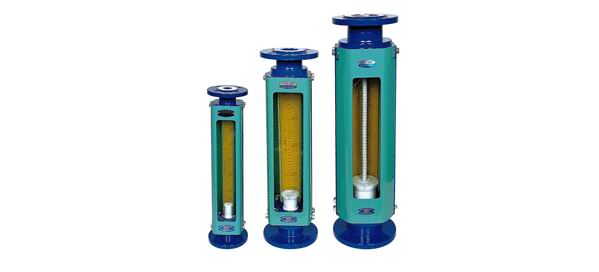

LZB-FÐͲ£Á§×ª×ÓÁ÷Á¿¼Æ¼¼Êõ²ÎÊý

      ·À¸¯ÐÍÁ÷Á¿¼ÆÓë½éÖʽӴ¥µÄÁ㲿¼þ²ÄÖÊ¡¢²¨¹ÜΪ¸ßÅð¹èÖʲ£Á§£¬»ù×ù¡¢¸¡×Ó¡¢µ¼¸ËÓɾÛËÄ·úÒÒÏ©³Ä°ü£¬ÃÜ·âȦ²ÉÓÃF46¸ôĤȦ
     ¹«³ÆÍ¨¾¶¡Ü10mmµÄ·À¸¯ÐÍÁ÷Á¿¼Æ£¬»ù×ù²ÄÖÊΪ²»Ðâ¸Ö£¬ÃÜ·â¼þ²ÄÁÏΪ·úÏ𽺡£
