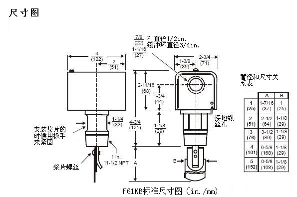

³£ÓÃÐͺż°¼¼ÊõÊý¾Ý
ÐͺÅ
F61KB£­11C
Á÷Ìå×î´óѹÁ¦
10°Í
Á÷ÌåζȠ   ×îµÍ
×î¸ß
4¡æ
120¡æ
»·¾³Î¶È
120¡æ
µ÷Õû·½·¨
ÓøÇÏÂÃæµÄµ÷ÕûÂÝË¿µ÷Õû
ÓëË®¹ÜµÄÁ¬½Ó·½Ê½
1""¹ÜÂÝÎÆ£¨Ñô£©
Á÷Á¿
¼ûÁ÷Á¿±í
Íâ¿Ç¼°¸Ç
À­Éì¸Ö°å
Á¬½Ó¹Ü
»ÆÍ­
ÄÚ²¿Áã¼þ
»ÆÍ­¼°Á×ÇàÍ­
Ë®·§
·§Á×ÇàÍ­
¶î¶¨µçÁ÷¡¢µçѹ
15(8)A,220VAC

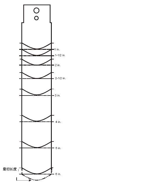

Á÷Á¿±í
ʹÓÃ1£­3in½°Æ¬Ê±Á÷Á¿

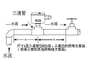

°²×°·½Ê½
