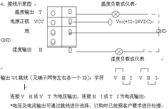

       CHT-D/NϵÁÐÎÂʪ¶È´«¸ÐÆ÷²ÉÓÃÓÅÖʽø¿Ú¸ß·Ö×ÓʪÃôÔª¼þ×÷Ϊʪ¶È²âÁ¿²¿¼þ¡¢²¬Èȵç×è(pt100,pt1000)×÷ΪζÈÃô¸ÐÔª¼þ£¬ÅäÒÔ¾«ÃÜÒDZíÔËËã·Å´óÆ÷£¬¼°×¨ÓÃV/IоƬµÈÐźŴ¦Àíµç·£¬½«»·¾³ÖеÄζÈÓëʪ¶Èת»»³ÉÓëÖ®Ïà¶ÔÓ¦µÄ±ê×¼Ðźš£

 2-1£®µçÔ´ £º        12VDC-24VDC£¨»ò24VAC£¬½öÏÞµçѹÊä³ö£©
 2-2£®Ê¹Ó÷¶Î§£º    ·À»¤µÈ¼¶£º IP65
              ÎÂ¶È £º    0 ~ 50¡æ»ò-20~80¡æ      ʪ¶È   £º 10%-100RH%
 2-3.£®±£´æÌõ¼þ£º    Î¶Ƞ £º -10 ~ 60¡æ       ʪ¶È   £º 90%RHÒÔÏÂ
 2-4£®Êª¶È±äËÍ·¶Î§£º0~100%RH
 2-5£®Êª¶È¾«¶È£º     ¡À2%RH£¨ÔÚ25¡æ£¬40~80%RH·¶Î§ÄÚ£©
                              ¡À3%RH £¨10%-40%£¬80-100%RH£©
 2-6£®Êª¶ÈÊä³öÐźţº0~5V£¨0-10V¿ÉÑ¡£©£¬4-20mA

         Ó÷¨À¼Á¬½Ó£¬½«´«¸ÐÆ÷̽ͷ²åÈë¹ÜµÀ£¬ÓÃËĸöM4Âݶ¤¹Ì¶¨·¨À¼£¬´ò¿ªÍâ¿Ç£¬½«Á¬½ÓÏßͨ¹ý·ÀË®½ÓÍ·Á¬½Ó¶Ë×Ó£¬È·ÈÏÁ¬ÏßÕýÈ·£¬¸ÇÉÏÍâ¿Ç£¬Å¡½ô½ÓÍ·
         ²»Ó÷¨À¼Á¬½Ó£¬½«´«¸ÐÆ÷̽ͷ²åÈë¹ÜµÀ£¬´ò¿ªÍâ¿Ç£¬Í¨¹ýÍâ¿Çµ×²¿Ëĸö¿×룬ÓÃÂÝË¿¹Ì¶¨±äËÍÆ÷£¬½«Á¬½ÓÏßͨ¹ý·ÀË®½ÓÍ·Á¬½Ó¶Ë×Ó£¬È·ÈÏÁ¬ÏßÕýÈ·£¬¸ÇÉÏÍâ¿Ç£¬Å¡½ô½ÓÍ·¡£
