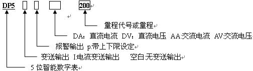

Ò»¡¢Ðͺż°º¬Òå
Ñ¡ÐÍʾÀý£ºÖ±Á÷µçѹ±í£¬Á¿³Ì10V£¬ÒªÇó´øÉÏ¡¢ÏÂÏÞ±¨¾¯£¬ÔòÑ¡ÐÍΪDp5-PDV10
