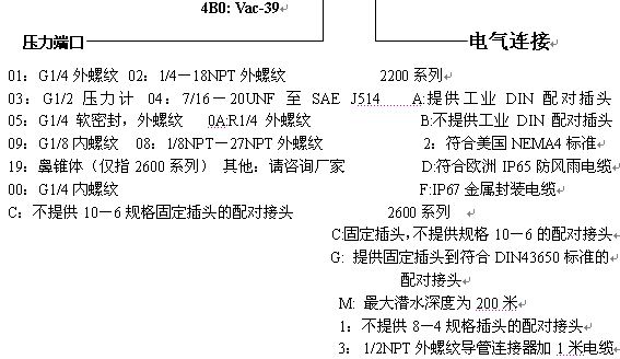

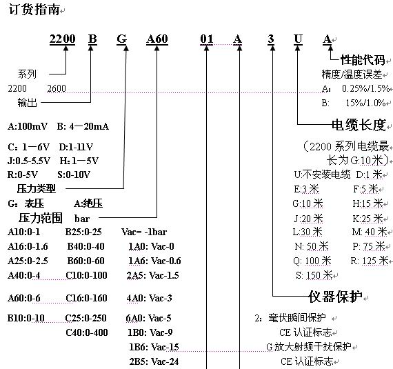

      2200CϵÁкÍ2600ϵÁвúÆ·¸»ÓÐÎȶ¨ÐÔ¡¢¾«È·ÐÔ£¬²¢ÓжàÖÖÍâ¿Ç¿É¹©Ñ¡Ôñ¡£2600ϵÁÐΪÂú×ãDZˮºÍ¹¤ÒµÓ¦ÓÃÐèÇóÌṩȫº¸½Ó²»Ðâ¸Öºó¶Ë£¬À©Õ¹ÁË·â×°Ñ¡Ôñ¡£2200ϵÁкÍ2600ϵÁоù²ÉÓþ­Êµ¼ùÖ¤Ã÷Ϊ¿É¿¿µÄCVD´«¸Ð¼¼Êõ£¬²¢ÅäÓÐASIC(ÌØ¶¨ÓÃ;¼¯³Éµç·)£¨·Å´ó×°Ö㩺ÍÄ£¿é·â×°£¬Ê¹´«¸ÐÆ÷Éú²úÏßÄÜÊÊÓ¦¸÷ÖÖÓ¦Ó㬲¢¶ÔÌØÊâÒªÇóÒ×½øÐе÷½Ú¶ø²»ËðÉË´«¸ÐÆ÷µÄ¸ßÐÔÄÜ¡£

»úе¹¹Ôì
ѹÁ¦¶Ë¿Ú
²Î¼û¶©¹ºµ¥
½ÓÒº²¿¼þ
17-4PH²»Ðâ¸Ö
µçÆøÁ¬½Ó
²Î¼û¶©¹ºµ¥
Íâ¿Ç
316²»Ðâ¸Ö,17-4PH²»Ðâ¸Ö
IP65¶ÔÓÚµçÆøÁ¬½Ó´úÂë A,B,C,D,G,1£¬2£¬3
IP67¶ÔÓÚµçÆøÁ¬½Ó´úÂë¡°F¡±¶øÑÔ
IP68¶ÔÓÚµçÆøÁ¬½Ó´úÂëM¶øÑÔ

ÌØÓм¼Êõ¹æ¸ñ
ºÁ·üÊä³ö
Êä³ö
100mV¡À1mV
¹©µçµçѹ£¨VS£©
10Vdc£¨×î´ó15V£©£¬Ð£×¼
µçÇŵç×è
2600¦¸¡«6000¦¸
µçѹÊä³ö
Êä³ö
²Î¼û¶¨¹ºµ¥
¹©µçµçѹ£¨VS£©
¸ßÓÚÂúÁ¿³ÌÊä³öµçѹ1.5Vdc£¬×î´ó¿É´ï35Vdc@6mA
¹©µçµçѹÁéÃôÐÔ
0.01%FS/V
×îС¸ºÔصç×è
£¨ÂúÁ¿³ÌÊä³ö/2£©K¦¸
µçÁ÷ÏûºÄ
µçѹÊä³öΪ7.5Vʱ£¬µçÁ÷ԼΪ6mA
µçÁ÷Êä³ö
Êä³ö
4¡«20mA(2Ïß)
¹©µçµçѹ£¨VS£©
24Vdc£¨7¡«35Vdc£©,ζȳ¬¹ý100¡ãC Ê±¹©µçµçѹÏÞÓÚ24Vdc)
¹©µçµçѹÁéÃôÐÔ
0.01%FS/V
×î´ó»ØÂ·µç×è
£¨Vs-7£©¡Á50¦¸
µçÆøÁ¬½Ó´úÂë
½ÓÏß´úÂë
µçÁ÷Êä³ö4£­20mA
µçѹÊä³ö
½ÓµØ
ÊäÈ룫
¹«ÓÃ
Êä³ö£«
½ÓµØ
A,B,G¹¤ÒµDIN
²å½Å
1
2
4
1
2
3
4
C 10£­6¿¨¿Ú
²å½Å
A
B
E
A
C
B
E
D µçÀÂ
R
BK
ÆÁ±ÎÏß
R
BK
W
ÆÁ±ÎÏß
F IP67µçÀÂ
R
BK
ÆÁ±ÎÏß
R
BK
W
ÆÁ±ÎÏß
1 8£­4¿¨¿Ú
²å½Å
A
B
D
A
C
B
D
3 µ¼¹ÜÓëµçÀÂ
R
BK
ÆÁ±ÎÏß
R
BK
W
ÆÁ±ÎÏß
M ͶÈëʽIP68ÖÁ200Ã×
R
BL
ÆÁ±ÎÏß
R
W
Y
ÆÁ±ÎÏß
R£½ºìÉ«£¬BL=À¶É«£¬BK=ºÚÉ«£¬W=°×É«£¬G=ÂÌÉ«£¬Y=»ÆÉ«
½ÓÏß´úÂë
µçÁ÷Êä³ö4£­20mA
ÊäÈ룫
Êä³ö£«
Êä³ö£­
ÊäÈ룭
A,B,G¹¤ÒµDIN
²å½Å
1
2
3
E
C 10£­6¿¨¿Ú
²å½Å
A
B
C
D
D µçÀÂ
R
Y
BL
G
F IP67µçÀÂ
R
Y
BL
G
1 8£­4¿¨¿Ú
²å½Å
A
B
C
D
3 µ¼¹ÜÓëµçÀÂ
R
W
G
BK
M ͶÈëʽIP68ÖÁ200Ã×
R
W
G
BK
