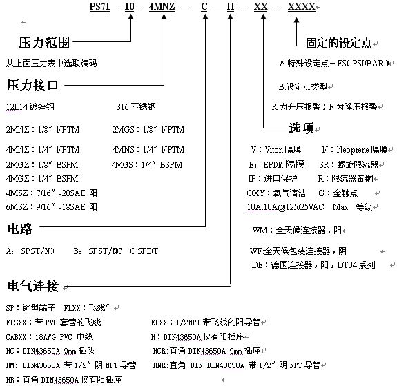

Ñ¡ÐÍÖ¸ÄÏ
ÀýÈ磺FS3BarF±íʾÔÚ3bar½µÑ¹Ê±±¨¾¯£»FS60PSIR±íʾÔÚ60psiÉýѹʱ±¨¾¯
×¢ÊÍ£º
1¡¢  ÆäËûÁ¬½ÓÆ÷¿ÉÑ¡£¬ÇëÓ빤³§ÁªÏµ¡£DIN43650A 9mm²å×ù
2¡¢  £­10AÑ¡Ôñ»ò£­GÑ¡Ôñ
3¡¢  18¡åÊDZê×¼³¤¶È£¬¿ÉÒÔ¶¨ÖÆÌØÊâµÄµçÀ³¤¶È£¨×48¡å£©ÀýÈ磺FL18»òÕßFLS30
4¡¢  18¡åÊDZê×¼³¤¶È£¬¿ÉÒÔ¶¨ÖÆÌØÊâµÄµçÀ³¤¶È£¨×48¡å£©ÀýÈ磺EL18»òÕßELS30
5¡¢  36¡å×îСֵ£¬¿ÉÒÔÑ¡ÔñµçÀ³¤¶È¡£ÀýÈ磺CAB36»òCAB120.
6¡¢  DINÁ¬½ÓÆ÷±ØÐëÊÇ£­CSPDTµç·ѡÔñ¡£
7¡¢  £­10AÑ¡Ôñ»ò£­GÑ¡Ôñ
8¡¢  ½øÏ10A£¬£­G»ò£­RD²»ÄÜͬʱѡÔñ
IPÑ¡Ïî½öÊÊÓÃÓÚ£­FL,-FLS»òCABµçÆøÁ¬½Ó£¬²¢ÇÒÒªÇó¹Ì¶¨µÄÉ趨µã£¨FS£©.
10¡¢É趨µã±ØÐëÔÚÑ¡ÔñµÄѹÁ¦·¶Î§ÄÚ¡£
