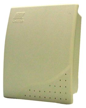

²úÆ·Ãû³Æ£º JWSL-9ϵÁбڹÒÐÍÎÂʪ¶È±äËÍÆ÷
ÐÍ ºÅ£º JWSL-9
Ò».¼ò½é¡¢ÓÃ;¡¢Ìص㣺
¼û08-09ÄêÑù±¾P37£¨JWSL-2£©
¶þ.¼¼Êõ²ÎÊý
¹©  µç£ºµçÁ÷ÐÍ£ºDC 24V£¨22V¡«26V£©
     µçѹÐÍ£ºDC 12V¡«24V
׼ȷ¶È£ºÊª¶È:¡À3£¥RH (5£¥RH¡«95£¥RH,25¡æ)
 Î¶È:¡À0.5¡æ(0¡æ¡«50¡æ£©
¹¤×÷ζȣº-10¡æ¡«60¡æ
³¤ÆÚÎȶ¨ÐÔ£ºÊª¶È:©‚1%RH/y
      ζȩ‚0.1¡æ/y
ÏìӦʱ¼ä£º©‚15s£¨1m/s·çËÙ£©
Êä³öÐźţºµçÁ÷Êä³öÐÍ£ºÁ½ÏßÖÆ4mA¡«20mA
    µçѹÊä³öÐÍ£º0V¡«5V
    ÍøÂçÊä³öÐÍ£ºRS485 »òRS232
¸ºÔØÄÜÁ¦£ºµçѹÊä³öÐÍ£ºÊä³ö×迹250¦¸
    µçÁ÷Êä³öÐÍ£º¡Ü500¦¸
°²×°·½Ê½£º±Ú¹Òʽ£ºÂÝË¿¹Ì¶¨Ç½Ãæ
Íâ¿Ç:     ABS°×É«85mm ¡Á 100mm ¡Á 24mm
Ñ¡ÐÍ£º
JWSL-9
ͨÓñڹÒ/ÂñÏßÐÍ
AT
Á½ÏßÖÆ4mA¡«20mAÊä³ö
VB
0¡«5VÊä³ö
W1
RS485Êä³ö
W2
RS232Êä³ö
