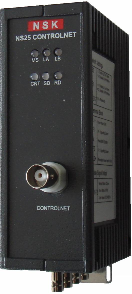

²úÆ·Ãû³Æ£º Controlnet×ÜÏß¹âÏËÁ´Â·Ä£¿é
ÐÍ ºÅ£º NS25
Ö÷ÒªÌØµãºÍÓÅÊÆ:
Ÿ    ²ÉÓõĵçÐż¼Êõ£ºSDH»·Íø¼¼Êõ¡¢TDM¼¼Êõ¡¢Á´Â·´«Êä¼¼Êõ¡¢Ïß·Êý¾ÝѹËõ¼¼ÊõµÈ
Ÿ    ×ÜÏ߽ṹ£ºÈ«¶ÔµÈ×ÜÏߣ¬¿ÉʵÏÖµã¶Ôµã¡¢µã¶Ô¶àµãµÈ½á¹¹¡¢¶àµã¶Ô¶àµãͨÐÅ
Ÿ    Ïß·ÈÝÁ¿£ºµ¥Â·Controlnet×ÜÏß
Ÿ    ÍøÂç½á¹¹£ºÐÇÐÍ¡¢Á´ÐÍ¡¢Ë«ÏË»·¡¢µã¶Ôµã£¬¼¶Á¬Õ¾Êý¿É´ï200̨
Ÿ    ´«ÊäÑÓʱ£º(Á´ÐÍÍøÂç) = 170ns * (Á½µã¼äµÄÕ¾Êý,²»°üÀ¨²âÁ¿µÄÁ½½Úµã) + 1100ns
            (»·ÐÎÍø)   = 170ns * (ÍøÖнڵãÊý-2) + 1100ns
Ÿ    ½â»··½Ê½£º²ÉÓÃLisRingרÓн⻷¼¼Êõ£¬×Ô¶¯Ð­ÉÌÉú³É¸ù½áµã£¬ÎÞÐèÈκÎÅäÖÃ
Ÿ    ½â»·ËÙ¶È£º¸ß´ï50msµÄ»·Íø×ÔÓúʱ¼ä£¬¹âÏËÁ¬½ÓʱÄÜ×Ô¶¯»Ö¸´
Ÿ    ×ÜÏß½Ó¿Ú£ºBNC
Ÿ    ´«ÊäÀàÐÍ£ºÐ­ÒéÐÍ,Controlnet×ÜÏßË÷
Ÿ    ¹â¿ÚÐÎʽ£ºST
Ÿ    ·¢¹â¹¦ÂÊ£º£¾-13dbm£¨µ¥Ä£ÏµÍ³£©   £¬£¾-20dbm£¨¶àģϵͳ£©
Ÿ    ÊÕ¹âÁéÃô¶È£º£¼-28dbm£¨µ¥Ä£ÏµÍ³£©£¬£¼-34dbm£¨¶àģϵͳ£©
Ÿ    ´«Êä¾àÀ룺µ¥Ä££¬0km ~ 20km£» ¶àÄ££¬0km ~ 3km
&#376;    ÊäÈëµçÔ´£ºDC9V-DC30V£¬ < 2W £»¿ÕÔØµäÐÍÖµDC24V@80mA Á¬Ðø
&#376;    LED״̬£º¹â¿ÚÏß·£¬Êý¾Ý¿Ú¡¢µçԴָʾ¡¢ÔËÐÐָʾ£¬¸æ¾¯
&#376;    ¸æ¾¯Êä³ö£º¼ÌµçÆ÷½Ó¿Ú£¬24V@1A,125VAC@0.2A
&#376;    »ú¿Ç½á¹¹£ºD35mmµ¼¹ìʽ£¬40x 110 x 74£¨mm£©
&#376;    »ú¿Ç¹¤ÒÕ£º½ðÊôÖýÔ죻·À»¤µÈ¼¶£ºIP40
&#376;    Õñ¶¯ÌØÐÔ£º·ûºÏIEC68-2-6
&#376;    ÖØ    Á¿£ºÔ¼500g
&#376;    ÎÂÊªÌØÐÔ£º¹¤×÷ζȣ¬-35¡æ ~ +75¡æ£»Êª¶È£º95%ÎÞÄý¶£»
&#376;    ´æÖüζȣº-45¡æ ~ +85¡æ
&#376;    ·ûºÏ±ê×¼£ºControlnet Standard
&#376;    µç´Å¼æÈÝ£ºEN61000-4-2£¨8KV»ú¿Ç¾²µç£©
            EN61000-4-3£¬ENV50204£¨¿¹µç´Å¸ÉÈÅ10V/mÔÚ10KHz-1GHz£©
            EN61000-4-4£¨2KV¿ìËÙÂö³åȺ£©
            EN61000-4-5£¨¹²Ä£1KV£¬²îÄ£2KVÀËÓ¿£©
            EN55022£¨·øÉä·ûºÏ class B£©
רΪControlnet×ÜÏ߹⴫ÊäÌṩµÄÍêÉÆµÄ²úÆ·ºÍ¼¼Êõ½â¾ö·½°¸
NS25ϵÁвúÆ·ÊÇÔÚ¶àÄêÉè¼ÆÑз¢¹úÄÚÏàËÆ²úÆ·µÄ»ù´¡ÉÏ£¬²Î¿¼RockwellµÄ1786ϵÁвúÆ·µÄ¹¦ÄÜ£¬²ÉÓöàÏî×îм¼ÊõÑз¢¶ø³ÉµÄControlnet×ÜÏßÊý¾Ý¹â¶Ë»ú¡£Ëü¿ÉÒÔÍê³Éͨ¹ý¹âÏË´«ÊäControlnetÏÖ³¡×ÜÏߣ¬ÔÚ¹¦ÄÜÉÏ¿ÉÒÔ´úÌæ1786-RPA,1786-RPFS,1786-RPFM,1786-RPFRL,1786-RPFRXL,1786-RPCDµÈ²úÆ·£¬ÔÚÓ¦ÓÃÉϱÈaÉÏÊö²úÆ·¼òµ¥¡£´Ë²úÆ·¾ßÓеÄÓŵãÓÐ:µÍ¹¦ºÄ¡¢¹¤Òµ¼¶Éè¼Æ¡¢µçÔ´ÊÊÓ¦ÐÔ¡¢ÓÅÃÀµÄÍâ¹ÛÓëµ¼¹ìʽ°²×°»ú¿ÇµÈµÈ¡­¡­£¬Í¬Ê±£¬»¹ÓÐÈçϼ¸¸öÍ»³öµÄÌØµã£ºÍ¬ÀàµÄ¹úÄÚÊ׿î½ðÊôÖýÔ칤ÒÕÍâ¿Ç,ʹ²úÆ·µµ´ÎÌá¸ßµ½ÐÂˮƽ¡¢ÌØÓеÄLisRing½â»·Ð­Òé¡¢ÐͺŷḻµÄϵÁл¯²úÆ·µÈ¡£
NS25ϵÁвúÆ·µÄÊý¾Ý½Ó¿Ú²ÉÓÃBNCͬÖá½Ó¿Ú£¬·ûºÏControlnet×ÜÏß±ê×¼¡£±¾²úÆ·²ÉÓÃTrueBus×ÜÏß¼¼Êõ£¬ÕæÕýÂß¼­ÉϵÄÈ«¶ÔµÈ×ÜÏߣ¬±¾¹â×ÜÏß²ÉÓÃÊý¾Ý͸Ã÷´«Êä¼¼Êõ£¬Ö§³ÖControlnet×ÜÏßËÙÂÊ,ÔÚÑÓÊäÐÔÄÜÉÏÓëRockwellµÄ1786ϵÁвúÆ·Ï൱¡£
±¾²úÆ·Ó¦ÓÃÁé»î£¬¿ÉÒÔ×é³É¶àÖÖ¹âÏËÍøÂç¡£²ÉÓõã¶ÔµãµÄÍøÂçʱ¿ÉÒÔʵÏÖͨ¹ý¹âÏËÁ¬½ÓÁ½¸öControlnet×ÜÏßµÄÍø¶Î£»²ÉÓõ¥¹â¿ÚµÄ²úƷͨ¹ýµç¿Ú×ÜÏßʵÏÖÐÇÐÎÍøÂ磬¿ÉÒÔʵÏÖ¶à¸ö²»Í¬µÄControlnet×ÜÏßÍø¶ÎµÄÁ¬½Ó£»²ÉÓÃË«¹â¿ÚÁ´ÐÎÍøÂçµÄ¹âÏË×ÜÏßÉÏʵÏֶԵȵÄControlnet×ÜÏߣ»Í¬Ê±£¬±¾²úÆ·»¹¿ÉÒÔʵÏÖË«ÏË»·ÍøÈßÓ๦ÄÜ£¬µ±ÍøÂçÖеÄij´¦¹âÏ˹ÊÕÏʱ£¬ÏµÍ³»áÔÚ50msÄÚÖØ½¨ÍøÂçµÄÁ´Â·£¬±£Ö¤È«ÍøµÄͨÐÅÕý³££¬ÊµÏÖControlnet¹â×ÜÏßµÄ×ÔÓú±£»¤£¬ÍøÂç¹ÊÕÏÅųýºóϵͳ»á×Ô¶¯»Ö¸´¡£
NS25ϵͳµÄÁíÒ»¸ö´óÌØµãÊDzÉÓÃרÓÐLisRing½â»·Ð­Ò飬±¾Ð­ÒéÊDzο¼RSTPЭÒéµÄ»ù´¡ÉϲÉÓÃÓ²¼þʵÏֵĻ·ÍøÉÏ¿ìËٽ⻷ЭÒ飬²»ÐèÈκÎÉèÖ㬿ÉÒÔÔÚ50msÄÚ×Ô¶¯Éú³ÉÍøÂç¸ù½Úµã£¬Ò²¾ÍÊÇÍøÂçµÄ½â»·µã£¬²¢Í¬Ê±Íê³É½â»·¹¦ÄÜ¡£²ÉÓñ¾¼¼ÊõʵÏÖ¼´²å¼´ÓÃÐͲúÆ·£¬²»ÐèÅäÖ㬲åÉϾÍÄÜÓ㬼«´óµØ¼ò»¯ÁËÓû§µÄµ÷ÊÔ¹ý³Ì£¬½µµÍÁËÓû§µÄʹÓÃÄѶȣ¬Ò²²»»á³öÏÖÅäÖò»ºÃÉ豸ÔËÐв»Õý³£µÄÏÖÏó¡£
±¾ÏµÁвúÆ·ÖеÄÍâ¿Ç²ÉÓýðÊôÖýÔìÍâ¿Ç£¬ºñÖØ¶ø¸ßµµ£»Í¬Ê±±¾²úÆ·»¹ÓпíµçÔ´¡¢µÍ¹¦ºÄ¼°ÍøÂç¸æ¾¯Êä³öµÈ¹¦ÄÜ¡£NS25ϵÁвúÆ·ÓжàÖÖÐͺţ¬¿ÉÍ¬ÍøÔËÐУ¬¸øÓû§Ê¹ÓôøÀ´×ã¹»µÄÑ¡ÔñÓàµØ£¬×î´óÏ޶ȵØÂú×ãÓû§µÄÐèÇó¡£±¾²úÆ·¿ÉÒÔÌṩOEM²úÆ·¡£
