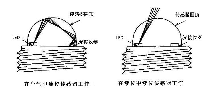

      »ôÄáΤ¶ûLLϵÁÐҺλ¿ª¹Ø¿ÉÌṩ·Ç³£×¼È·¡£¿É¿¿µÄҺλ²âÁ¿¡£1¸öLEDºÍ1¸öµÄ¹âµç½ÓÊÕÆ÷±»·ÅÈëËÜÁϵİëÔ²ÇòÄÚ£¬¸ù¾Ý¹âµÄÄÚ²¿·´ÉäÔ­Àí£¬µ±ÎÞÒºÌåʱ£¬¾ø´ó¶àÊýLED¹â¶¼»á¶¼»á±»¹âµç½ÓÊÕÆ÷ÊÕµ½£¬µ±ÒºÃ渲¸ÇÇò±íÃæÊ±£¬Ô²Çò¶¥ÓëÒºÌå½ØÃæµÄÕÛÉäϵÊý·¢Éú±ä»¯£¬¹âµç½ÓÊÕÆ÷ÊÕµ½LED¹â½«»á¼õÉÙ£¬Òò´ËÊä³ö½«»á·¢Éú±ä»¯£¬¿ª/¹ØÊä³öÐźÅÄÜÖ±½ÓÓëPLCÏàÁ¬¡£
         ´«¸ÐÔª¼þ±»ÃÜ·âÔÚ¾Ûí¿ÖýÄ£Ô²ÇòÄÚ£¬Íâ¿ÇΪ¾Ûí¿£¬¶ÆÄø»ÆÍ­»ò²»Ðâ¸Ö£¬ÄÜÓÃÓÚ²âÁ¿¶àÖÖÒºÌå¡£´«¸ÐÆ÷ÄܳÐÊÜ362psiµÄѹÁ¦¼°85¡æµÄʹÓÃζȣ¨¸ßÎÂÐÍΪ125¡æ£©£¬¾Ûí¿£¨polysulfome£©ÖýÄ£Ô²»·ÊÇÒ»ÖÖÀíÏëµÄÈÈËܲÄÁÏ£¬Äֿܵ¹ÖîÈ硪ËáÒº¡¢¼îÒº¡¢ÑÎÒº¡¢Ï´½à¾«ºÍ̼ÇâÓ͵ÄÇÖÏ®¡£

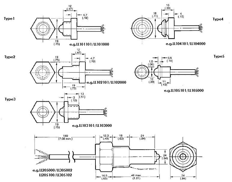

³ß´ç
             ËÜÁÏ                ½ðÊô
Ô°¶¥      3.5mm radius     3.5mm radius
ÂÝÎÆ      M12¡Á1             1/2¡±BSPT
Áù½Ç      19mm               24mm

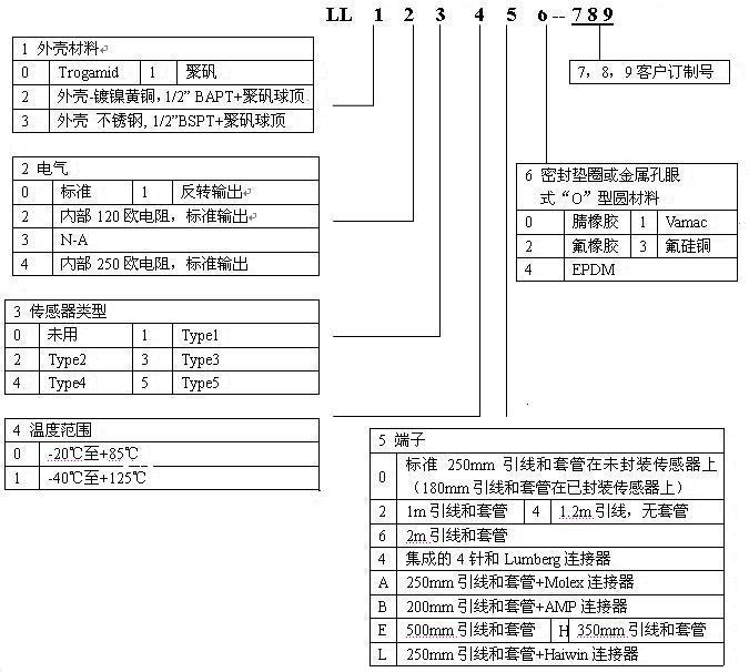

³£ÓÃÐͺÅ
ÍÆ¼öÐͺÅ
ÀàÐÍ
LL101000
³£ÎÂ
LL101101
³£ÎÂ
LL103101
³£ÎÂ
Ñ¡Ð;ÙÀý£º
ÐͺÅ
ÆÕͨÐÍ
¸ßÎÂÐÍ
ÃèÊö
¾Û·¯
LL101000
LL102000
LL103000
LL104000
LL105000
LL101101
LL102101
LL103101
LL10401
LL105100
7mm,M12¡Á1ÂÝÎÆ£¬Íⲿ°²×°
10mm,M12¡Á1ÂÝÎÆ£¬Íⲿ°²×°
ÍÆÈëÐÍ£¬Ö±¾¶16.5-17.5£¬Íⲿ°²×°
ÍÆÈëÐÍ¡£Ö±¾¶10£¬ÄÚ²¿°²×°
¶ÆÄø»ÆÍ­
LL20500-1
LL20500-1
LL205102-1
LL205112-1
180 mmµ¼Ïß/»¤Ì×
1 mmµ¼Ïß/»¤Ì×
²»Ðâ¸Ö
LL305002-1
LL305012-1
LL305102-1
LL305112-1
180 mmµ¼Ïß/»¤Ì×
1 mmµ¼Ïß/»¤Ì×
×¢£º³£ÎÂÐÍÄÚº¬ëæÏ𽺣¨nitrile£©OÐÍȦ£¬¸ßÎÂÐÍÄÚº¬·ú»¯Ïð½ºvitonÐÍȦ
