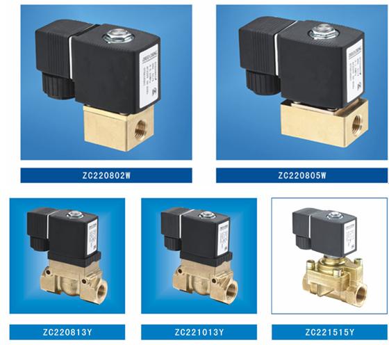

²úÆ·Ãû³Æ£º ¶þλ¶þͨ¸ßѹµç´Å·§
ÐÍ ºÅ£º DJ
 ¶þλ¶þͨ¸ßѹµç´Å·§
ͼÐηûºÅ
²úƷ˵Ã÷
¸ßѹµç´Å·§²ÉÓûîÈûʽ½á¹¹£¬Ä͸ßѹÃÜ·â¼þ£¬Ê¹ÓÃÊÙÃü³¤£¬¶¯×÷ÁéÃô¿É¿¿£¬¹¤×÷ѹÁ¦×î¸ß¿É´ï15Mpa£¬¹ã·ºÊÊÓÃÓÚ¼ÓʪÆ÷£¬´µÆ¿»úе£¬¿Õѹ»úµÈ£¬ÒÔϹæ¸ñ¿ÉÑ¡×ö·À±¬£¬¶¨Ê±£¬ÌØÊâ¹æ¸ñ¿É¶¨×ö¡£
¼¼Êõ¹æ¸ñ
ÐͺÅ
½Ó¿ÚG
ѹÁ¦MPa
¹«³ÆÍ¨¾­¡é
»·¾³Î¶È
½éÖÊζÈ
KVÖµM3/H
µçѹ
ZC220601-Y
G1/8¡±
0-5.0
1
-10¡«50¡æ
-10¡«90¡æ
0.14
¿ÉÑ¡
ZC220802-Y
G1/4¡±
0-3.0
2
0.24
ZC220813-Y
G1/4¡±
0.3-5.0
13
4.6
ZC221013-Y
G3/8¡±
0.3-5.0
13
4.6
ZC221513-Y
G1/2¡±
0.3-5.0
13
4.6
ZC220815-Y
G1/4¡±
0.3-5.0
15
5.8
ZC221015-Y
G3/8¡±
0.3-5.0
15
5.8
ZC221515-Y
G1/2¡±
0.3-5.0
15
5.8
ZC222020-Y
G3/4¡±
0.3-4.0
20
10.3
ZC222525-Y
G1¡±
0.3-4.0
25
15.3
³ß´çͼ
³ß´ç
ÐͺÅ/¶©»õºÅ
A
B
C
D
E
F
G
ZC220601-Y
32
40
67
78
36
32
34
ZC220802-Y
ZC220813-Y
71
100
93
22
ZC221013-Y
ZC221513-Y
ZC220815-Y
75
102
94
53
ZC221015-Y
ZC221515-Y
ZC222020-Y
92
126
126
41
62
ZC222525-Y
118
127
127
26
73
