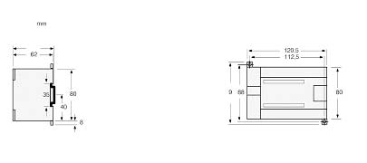

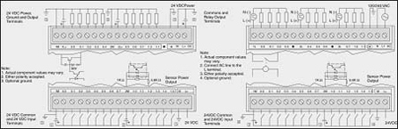

CPU 224 DC/DC/DC Á¬½ÓÆ÷¶Ë×Óͼ
CPU 224 ³ß´çͼ
