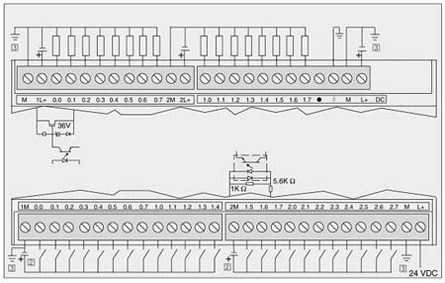

CPU 226 DC/DC/DC ¶Ë×ÓÁ¬½Óͼ

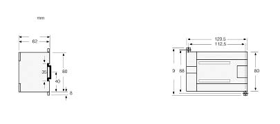

CPU226 ³ß´çͼ
