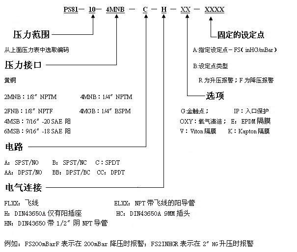

Ñ¡ÐÍÖ¸ÄÏ
×¢ÊÍ£º
1¡¢  18¡åÊDZê×¼³¤¶È£¬¿ÉÒÔ¶¨ÖÆÌØÊâµÄµçÀ³¤¶È£¨×48¡å£©ÀýÈ磺FL18»òÕßFLS30
2¡¢  18¡åÊDZê×¼¡£ÌØÊâµÄµçÀ³¤¶È¿ÉÑ¡£¨×48¡å£©¡£ÀýÈ磺£­EL18»òEL30
3¡¢  DINÁ¬½ÓÆ÷±ØÐëΪ£­C SPDT»ØÂ·
4¡¢ ½ø¿Ú±£»¤½ö¶Ô£­FSµç×Ó¶Ë×ÓÊÇÖ¸¶¨É趨µã²úÆ·£­FS¡£
5¡¢ É趨µã±ØÐëÔÚµÚÒ»²½Ñ¡ÔñµÄѹÁ¦·¶Î§ÄÚ¡£
