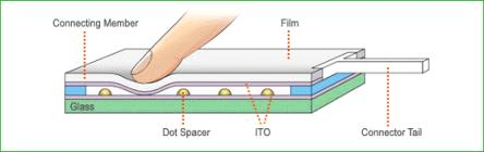

 ËÄÏß´¥ÃþÆÁ¹¤×÷Ô­Àí
ËÄÏßµç×èʽ´¥ÃþÆÁÊǵç×èʽ¼Ò×åÖÐÓ¦ÓÃ×î¹ã¡¢×îÆÕ¼°µÄÒ»ÖÖ¡£Æä½á¹¹ÓÉÏÂÏß·£¨²£Á§»ò±¡Ä¤²ÄÁÏ£©µ¼µçITO²ãºÍÉÏÏß·£¨±¡Ä¤²ÄÁÏ£©µ¼µçITO²ã×é³É¡£ÖмäÓÐϸ΢¾øÔµµã¸ô¿ª£¬µ±´¥ÃþÆÁ±íÃæÎÞѹÁ¦Ê±£¬ÉÏÏÂÏß·³É¿ªÂ·×´Ì¬¡£Ò»µ©ÓÐѹÁ¦Ê©¼Óµ½´¥ÃþÆÁÉÏ£¬ÉÏÏÂÏß·µ¼Í¨£¬¿ØÖÆÆ÷ͨ¹ýÏÂÏß·µ¼µçITO²ãÔÚX×ø±ê·½ÏòÉÏÊ©¼ÓÇý¶¯µçѹ£¬Í¨¹ýÉÏÏß·µ¼µçITO²ãÉϵÄ̽Õ룬Õì²âX·½ÏòÉϵĵçѹ£¬ÓÉ´ËÍÆËã³ö´¥µãµÄX×ø±ê¡£Í¨¹ý¿ØÖÆÆ÷¸Ä±äÊ©¼ÓµçѹµÄ·½Ïò£¬Í¬Àí¿É²â³ö´¥µãµÄY×ø±ê£¬´Ó¶øÃ÷È·´¥µãµÄλÖá£

ËÄÏß´¥ÃþÆÁ¹¤×÷Ô­Àíͼ: (4-Wire Analog Resistive Operation principles)
