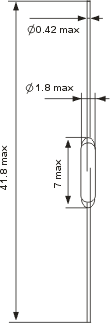

²úÆ·Ãû³Æ£º ¸É»É¹ÜMKA-07101
ÐÍ ºÅ£º MKA-07101
Part No.
ÐͺÅ
MKA-07101
Total Length
×ܳ¤¶È
41.8 mm
Glass Length
²£Á§³¤¶È
7 mm
Glass Diameter
Ö±¾¶
1.8 mm
Contact Form
´¥µãÐÎʽ
1A £¨ SPST-NO £©
Contact Position
´¥µãλÖÃ
SYM
Contact Material
´¥µã²ÄÖÊ
Ru
Contact Rating
´¥µã¸ºÔØ
1W
Max. Switching Voltage
×î´ó¿ª¹Øµçѹ
24 VDC / VAC
Max. Switching Current
×î´ó¿ª¹ØµçÁ÷
0.1A
Contact Resistance
(at initial value)
½Ó´¥µç×è ( ³õʼֵ )
200 mOhms
Pull In Value (AT)
Æô¶¯Öµ
7-35
Drop Out Value (AT)
ÊÍ·ÅÖµ
4
Operation Time
¶¯×÷ʱ¼ä
0.3 mSec.(Max.)
Release Time
ÊÍ·Åʱ¼ä
0.1 mSec.(Max.)
Breakdown Voltage
Ä͸ßѹ
150 VDC
Contact Capacitance
´¥µãµçÈÝ
0.4 pF
Insulation Resistance
¾øÔµµç×è
109Ohms
Resonant Frequency
гÕñƵÂÊ
12 kHz
Operation Temperature
¹¤×÷ζȷ¶Î§
-60 ¡æ ~+125 ¡æ
High Humidity
×î¸ßʪ¶È
98% (Max.)
Operation Frequency
×î¸ß¹¤×÷ƵÂÊ
400 Hz
Electrical Life
µçÆøÊÙÃü
5¡Á107£¨50mV£¬10mA£©
2¡Á107£¨5V£¬10mA£©
Test Coil
²âÊÔÏßȦ
5000 ¡¡580 Ohm
Leads
ÒýÏß½Å
Gold-Plated ¶Æ½ð
Safety
°²È«ÈÏÖ¤
UL
