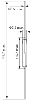

Part No.
ÐͺÅ
MKA-14103
Total Length
×ܳ¤¶È
44.7 mm
Glass Length
²£Á§³¤¶È
14.2 mm
Glass Diameter
Ö±¾¶
2.3 mm
Contact Form
´¥µãÐÎʽ
1A (SPST-NO)
Contact Position
´¥µãλÖÃ
SYM
Contact Material
´¥µã²ÄÖÊ
Ru
Contact Rating
´¥µã¸ºÔØ
10W
Max. Switching Voltage
×î´ó¿ª¹Øµçѹ
100 VDC / VAC
Max. Switching Current
×î´ó¿ª¹ØµçÁ÷
0.5A
Contact Resistance
(at initial value)
½Ó´¥µç×è ( ³õʼֵ )
100 mOhms
Pull In Value (AT)
Æô¶¯Öµ
10-35
Drop Out Value (AT)
ÊÍ·ÅÖµ
5
Operation Time
¶¯×÷ʱ¼ä
1.0 mSec.(Max.)
Release Time
ÊÍ·Åʱ¼ä
0.4 mSec.(Max.)
Breakdown Voltage
Ä͸ßѹ
220VDC(AT<25)/
250VDC(AT>25)
Contact Capacitance
´¥µãµçÈÝ
0.7 pF
Insulation Resistance
¾øÔµµç×è
1010Ohms
Resonant Frequency
гÕñƵÂÊ
4 kHz
Operation Temperature
¹¤×÷ζȷ¶Î§
-60 ¡æ ~+155 ¡æ
High Humidity
×î¸ßʪ¶È
98% (Max.)
Operation Frequency
×î¸ß¹¤×÷ƵÂÊ
100 Hz
Electrical Life
µçÆøÊÙÃü
108(5V ,10mA)
105(24V, 400mA)
Test Coil
²âÊÔÏßȦ
5000 ¡¡870 Ohm
Leads
ÒýÏß½Å
Gold-Plated ¶Æ½ð
Safety
°²È«ÈÏÖ¤
UL
