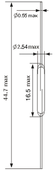

²úÆ·Ãû³Æ£º ¸É»É¹ÜMKA-16101
ÐÍ ºÅ£º MKA-16101
Part No.
ÐͺÅ
MKA-16101
Total Length
×ܳ¤¶È
44.7 mm
Glass Length
²£Á§³¤¶È
16.5 mm
Glass Diameter
Ö±¾¶
2.54 mm
Contact Form
´¥µãÐÎʽ
1A£¨SPST-NO£©
Contact Position
´¥µãλÖÃ
SYM
Contact Material
´¥µã²ÄÖÊ
Ru
Contact Rating
´¥µã¸ºÔØ
10W
Max. Switching Voltage
×î´ó¿ª¹Øµçѹ
100 VDC / VAC
Max. Switching Current
×î´ó¿ª¹ØµçÁ÷
0.5A
Contact Resistance
(at initial value)
½Ó´¥µç×è ( ³õʼֵ )
100 mOhms
Pull In Value (AT)
Æô¶¯Öµ
10-35
Drop Out Value (AT)
ÊÍ·ÅÖµ
5
Operation Time
¶¯×÷ʱ¼ä
1.0 mSec.(Max.)
Release Time
ÊÍ·Åʱ¼ä
0.4 mSec.(Max.)
Breakdown Voltage
Ä͸ßѹ
220 VDC
Contact Capacitance
´¥µãµçÈÝ
0.3 pF
Insulation Resistance
¾øÔµµç×è
109Ohms
Resonant Frequency
гÕñƵÂÊ
3 kHz
Operation Temperature
¹¤×÷ζȷ¶Î§
-60¡æ~+125¡æ
High Humidity
×î¸ßʪ¶È
98% (Max.)
Operation Frequency
×î¸ß¹¤×÷ƵÂÊ
400Hz
Electrical Life
µçÆøÊÙÃü
1¡Á108£¨50mV£¬5¦ÌA£©
2¡Á106£¨5V£¬10mA£©
1¡Á105£¨14.5V£¬270mA£©
1¡Á106£¨24V£¬250mA£©
Test Coil
²âÊÔÏßȦ
5000  620 Ohm
Leads
ÒýÏß½Å
Safety
°²È«ÈÏÖ¤
