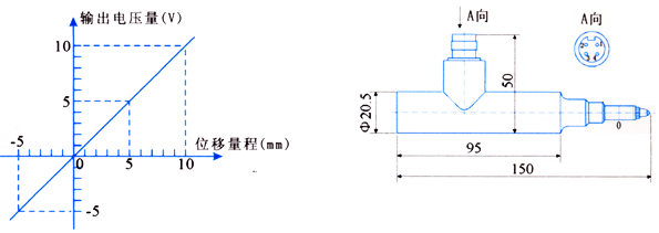

Ö÷Òª¼¼Êõ²ÎÊý£º
    1.Á¿³Ì£º0-10mm¡¢¡À5mm
    2.²âÁ¿¾«¶È£º¡À0.1%¡¢¡À0.2%¡¢¡À0.3%¡¢¡À0.5%
    3.·Ö±æÁ¦£º¡À0.01V
    4.ÏßÐÔ¶È£º¡À0.05%F.S
    5.×î´óÊä³öµçÁ÷£º8mA
    6.Êä³öµçѹ£º0-10VDC¡¢¡À5VDC
    7.´«¸ÐÆ÷ʹÓû·¾³Î¶ȣº0¡æ-70¡æ
    8.¹©µçµçѹ£º¡À12VDC-¡À18VDC
    9.µçÔ´ÎÆ²¨ÏµÊý£º<=3mv.rms
    10.ÏûºÄ¹¦ÂÊ£º<=2W
    11.¾øÔµµç×裺>=20M¦¸
    12.Î»ÒÆÁ¿ÓëÊä³öµçѹµÄ¹ØÏµ£¬¼û×óÏÂͼ£º
    13.ÍâÐγߴç¼ûÓÒÏÂͼ£º
