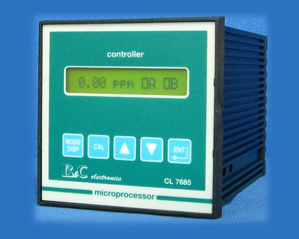

²úÆ·Ãû³Æ£º CL7685.010ÓàÂÈÒÇ
ÐÍ ºÅ£º CL7685.010
CL7685.010ÓàÂÈÒÇ
CL7685.010ÓàÂÈÒÇ
           CL7685ÓàÂÈÒÇÓ¦Ó÷¶Î§:
ÒûÓÃË®(×ÔÀ´Ë®¡¢´¿Ë®£©¡¢ÎÛË®´¦Àí¡¢×°Æ¿Òµ
               CL7685ÓàÂÈÒǹ¦ÄÜ
               * ÊäÈëÐźÅÀ´×ÔĤѡÔñµç¼«´«¸ÐÆ÷
               * ÓàÂÈ¡¢¶þÑõ»¯ÂÈ¡¢×ÜÂÈ¡¢³ôÑõ´«¸ÐÆ÷
               * ×ÜÂÈÆøÃô´«¸ÐÆ÷
                * ζÈÏÔʾ
               * ×Ô¶¯»òÊÖ¶¯Î¶Ȳ¹³¥
               * Êä³ö£º0-20mA»ò4-20mA¿ÉÑ¡
               * ×Ô¶¯¡¢ÊÖ¶¯»òÄ£Äâ²Ù×÷
              * ζÈÊäÈëÐźÅÀ´×Ô3Ïßt100Èȵç×è
               * Á¿³Ì£º0-2ppm¡¢0-20ppm¡¢0-200ppm×Ô¶¯µ÷½Ú
               * ³ÌÐòɸѡ
               * УÑéģʽ£ºÁ¢¼´¡¢ÑÓ³Ù
               * ÏÔʾÉèÖòÎÊý
               * É趨µã¼°¾¯±¨Ìõ¼þÉèÖÃÏÔʾ
               * Ë«µãÉèÖÃ
               * ¹¦ÄÜÑ¡Ôñ£º¿ª/¹Ø¡¢Âö³å±ÈÀýʽµ÷½Ú£¨PFM£©        ¼äЪÂö³å±ÈÀýʽµ÷½Ú£¨PWM£©
                * ´øÖͺó¡¢ÑÓ³Ù¡¢¸ß/µÍ¶¯×÷ÉèÖù¦ÄÜ
                * ×Ô¶¯¹ýÔØ±£»¤¼°»Ö¸´ÉèÖÃ
                * ¿É°Îʽ¶Ë×Ó°å
                * ÍâÐͳߴ磺96¡Á96¡Á155mm
                CL7685ÓàÂÈÒDzÎÊý
                ÊäÈëµçÁ÷    ÔÚ20¡æÊ±£¬160nA¶ÔÓ¦1ppm
                CL7685ÓàÂÈÒÇÁ¿³Ì
                 0-2.000ppm¡¢0-20.00ppm»ò0-200.0ppm
                  (CL2¡¢CLO2¡¢D.O3¡¢SO2-3£©
                Áãλµ÷Õû£º¡À200nA
                ´«¸ÐÆ÷ÁéÃô¶È£º12.5/250%
                 Èí¼þ¹ýÂË£º 0.6-99.9Ãë
                ¼«»¯µç³Øµçѹ£º-200mV£¨0¡«1250mV£©
                ζÈϵÊý£º0/4.0%/¡æ
             CL7685ÓàÂÈÒÇPFM/PWM¹¦ÄÜ
                ±ÈÀý·¶Î§£ºÁ¿³ÌµÄ0-10%
                Âö³åƵÂÊ£º0-120´Î/·ÖÖÓ
                Âö³åÖÜÆÚ£º0-99.9Ãë
                CL7685ÓàÂÈÒÇζÈ
                ÊäÈëÐźţº3ÏßÖÆPt100Èȵç×è
                ²âÁ¿¼°²¹³¥·¶Î§£º-2¡«52¡æ
                ·Ö±çÂÊ£º0.1¡æ
                Áãλµ÷Õû£º¡À1¡æ
                A¡¢Bµã¹¦ÄÜÉèÖÃ
                ¹¦ÄÜÑ¡Ôñ£º¿ª/¹Ø-Âö³å±ÈÀýʽµ÷½Ú£¨PFM£©
            CL7685ÓàÂÈÒǸ½¼þ£¨¸ù¾ÝÓû§ÐèÒª¶ø¶¨£©
                CL7901´ø´«¸ÐÆ÷ºãÁ÷Æ÷¹©ÓàÂȲâÁ¿ÓÃ
                OZ7901´ø´«¸ÐÆ÷ºãÁ÷Æ÷¹©³ôÑõ²âÁ¿ÓÃ
                ²âÁ¿×ÜÂÈ¡¢ÑÇÁòËáÑÎÓô«¸ÐÆ÷
                ²âÁ¿×ÜÂÈÓÃÆøÃô´«¸ÐÆ÷
             CL7685ÓàÂÈÒÇÑ¡Åä091.3711
                ˫ģÄâÐźÅÊä³ö
                Óû§¿ÉÑ¡ÔñζÈÊä³ö
              CL7685ÓàÂÈÒDZ¸¼þ£¨Ñ¡Å䣩
                0012.000066  ÓàÂÈ´«¸ÐÆ÷
                0012.050002  ²âÁ¿³ôÑõÓñ¡Ä¤10ÕÅ
                0012.090008  ²âÁ¿³ôÑõÓõç½âÒº125ºÁÉý
                0012.000043  ºãÁ÷Æ÷
                0012.030029  7.5m³¤µçÀÂ
                0012.050004  "O"ÐÎÃÜ·â»·¼°Âݶ¤
                0012.050005  ²âÁ¿ÓàÂÈÓñ¡Ä¤10ÕÅ
                0012.090011  ²âÁ¿ÓàÂÈÓõç½âÒº125ºÁÉý
                0012.000042  ³ôÑõ´«¸ÐÆ÷
