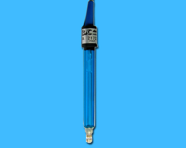

         SZ283ºãµçѹµç¼«ÓÃÓÚ²âÁ¿Ë®ÌåÖÐÓàÂÈ¡¢¶þÑõ»¯ÂÈ¡¢³ôÑõ¡£ºãµçѹ²âÁ¿·½·¨ÊÇÔڵ缫²âÁ¿¶Ë±£³ÖÒ»¸öÎȶ¨µÄµçÎ»ÊÆ£¬²»Í¬µÄ±»²â³É·ÝÔڸõçÎ»ÊÆÏ²úÉú²»Í¬µÄµçÁ÷Ç¿¶È¡£ËüÓÉÁ½¸ö²¬½ðµç¼«ÓëÒ»¸ö²Î±Èµç¼«×é³ÉÒ»¸ö΢µçÁ÷²âÁ¿ÏµÍ³¡£
         ºãµçѹ²âÁ¿·¨ÊÇͨ¹ý¶þ´ÎÒDZí¶Ô²âÁ¿µç¼«¼äµÄµçÎ»ÊÆ½øÐв»¼ä¶ÏµØ¶¯Ì¬¿ØÖÆ£¬Ïû³ýÁ˱»²âË®Ñù¹ÌÓеĵç×èÓëÑõ»¯»¹Ô­µçλµÄÓ°Ï죬ʹµç¼«²âÁ¿µçÁ÷ÐźŠÓë±»²âË®ÑùŨ¶ÈÖ®¼äÐγÉÁ¼ºÃµÄÏßÐÔ¹ØÏµ£¬¾ßÓзdz£Îȶ¨ÁãµãÐÔÄÜ£¬È·±£²âÁ¿×¼È·¿É¿¿¡£
         Á÷¾­²âÁ¿µç¼«µÄË®ÑùÖÐÓàÂÈ¡¢¶þÑõ»¯ÂÈ¡¢³ôÑõ»á±»ÏûºÄµô£¬ËùÒÔ£¬²âÁ¿Ê±±ØÐë±£³ÖË®ÑùÁ¬Ðø²»¶ÏÁ÷¹ý²âÁ¿µç¼«¡£ÓÉÓÚ±»²âË®Ñùµç×èÓëÑõ»¯»¹Ô­µçλµÄÓ°Ï죬´«Í³µçÁ÷²â¶¨·¨ÔÚ±»²â³É·Ý Å¨¶ÈÓë²âÁ¿µç¼«Ëù²úÉúµçÁ÷ÐźÅÖ®¼äºÜÄѱ£³ÖÒ»¸öÏßÐÔ¹ØÏµ£¬ÌرðÔÚË®Ñù±»²â³É·ÝŨ¶È½Ó½ü0ppmÇé¿öÏ£¬Æ«²î»á·Ç³£´ó£¬ËùÒÔ£¬´«Í³µçÁ÷²âÁ¿·¨ÐèÒª¶Ô²âÁ¿µç¼«½øÐÐÆµ·±Ð£Õý£¬¸øÊ¹ÓÃÕß´øÀ´Ðí¶àÂé·³¡£
         SZ283ºãµçѹµç¼«½á¹¹¼òµ¥£¬Ò×ÓÚÇå½àÓë¸ü»»¡£²âÁ¿Ê±£¬±ØÐë±£Ö¤Á÷¾­SZ283²âÁ¿µç¼«µÄË®Á÷ËÙ¶ÈÎȶ¨¡£ËùÒÔ£¬½¨ÒéÓëºãÁ÷Æ÷SZ7231»òSZ7233ÅäºÏʹÓá£
     ²âÁ¿·½·¨¼° ÐÔÄÜ
                ±È½Ï
      Ò»Ì廯Ĥµç¼«              ºãµçѹµç¼«
  ÏìӦʱ¼ä£¨90%£©            30-60Ãë                  1-5Ãë
  ¸ü»»Ä¤Æ¬              ÐèÒª                ²»ÐèÒª
  ¸ü»»µç½âÒº              ÐèÒª                ²»ÐèÒª
  ά»¤ÄÑÒ×            ½Ï¸´ÔÓ                   ¼òµ¥
  ά»¤ÖÜÆÚ  Ä¤Æ¬Ò׶»¤,ά»¤Æµ·±      ÎÞĤƬ£¬Î¬»¤ÖÜÆÚ³¤
¼¼Êõ²ÎÊý
                 µçÀ³¤¶È£º3Ã×Èýо¶ÆÒøµçÀÂ
                 ¹¤×÷ѹÁ¦£º10barÔÚ20¡æ
                 ³ß        ´ç£º³¤¶È110mm£¬Ö±¾¶12mm
                 µç       ¼«£ºÁ½²¬½ð»·
                 ²Î±Èµç¼«£ºgel´øannular½Óµã
                 ±¾Ìå²ÄÁÏ£º²£Á§
