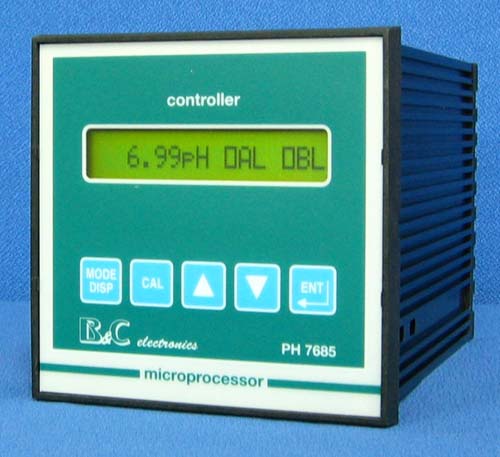

²úÆ·Ãû³Æ£º Æ¥´ÅPH7685£¨ORP£©¼à²âÒÇ
ÐÍ ºÅ£º PH7685£¨ORP£©
PH7685£¨ORP£©Ó¦Ó÷¶Î§£º
                  ÎÛË®´¦Àí¡¢Ê³Æ·¹¤Òµ¡¢ÒûÓÃË®¡¢
ÓÎÓ¾³Ø¡¢ÉúÎ﹤ÒÕ
Æ¥´ÅPH7685£¨ORP£©¼à²âÒǹ¦ÄÜ
                  * ζȶÁ³ö
                  * É趨²ÎÊýÏÔʾ
                  * É趨µã¼°¾¯±¨Ìõ¼þÉèÖÃÏÔʾ
                  * ×Ô¶¯»òÊÖ¶¯Î¶Ȳ¹³¥
                  * ²Ù×÷ģʽ£º×Ô¶¯¼°ÊÖ¶¯
                  * ¿É°Îʽ¶Ë×Ó°å
                  * ÍâÐͳߴ磺96¡Á96¡Á155mm
                  * 0-20mA»ò4-20mAÐźÅÊä³ö
                  * Öͺó¡¢ÑÓ³Ù¡¢¸ß/µÍ¶¯×÷ÉèÖù¦ÄÜ
                  * ¸ß/µÍÉèÖö¨Ê±±¨¾¯ÑÓ³Ù¹¦ÄÜ
                  * µç¿É²Á´æÖü
                  * ×Ô¶¯¹ýÔØ±£»¤¼°¸´Î»ÉèÖÃ
PH7685£¨ORP£©²ÎÊý
                 ´«¸ÐÆ÷ÀàÐÍ£º
                Æ¥´ÅPH7685£¨ORP£©¼à²âÒÇ PH²£Á§µç¼«/PHÌàµç¼«/ORPµç¼«/080102ǰÖ÷ŴóÆ÷
                 ÈýÏßÖÆPt100µç×èʽζȴ«¸ÐÆ÷
                  Ìàµç¼«
                 Áãλ£º-325mV=PH7£¬¡À2PH¿Éµ÷Õû
                 ±È½µ£º50mV/PH 25¡æÊ±£¬70/140%¿Éµ÷Õû
                ORPµç¼«
                 Áãλµ÷Õû£º¡À100mV
                 ÁéÃô¶Èµ÷Õû£º80-110%
                 ²£Á§µç¼«
                 Áãλ£º0.0mV=PH7£¬¡À2PH¿Éµ÷Õû
                 ±È½µ£º59.16mV/PH 25¡æÊ±£¬70/140%¿Éµ÷Õû
                  ²âÁ¿·¶Î§
                 PH£º0.00-14.00 ¡À0.01ph
                 ORP£º-1000¡«+1000mV¡À1mV
                 Èí¼þɸѡ£º0.4-50Ãë
                 ζÈ
                 ²âÁ¿¼°²¹³¥·¶Î§£º-10¡«+110¡æ
                 ·Ö±çÂÊ£º¡À0.1¡æ
                 Áãλµ÷Õû£º¡À2¡æ
                 ÊÖ¶¯Î¶Ȳ¹³¥£º-10.0¡«+110.0¡æ
                 Ñ¡¹º¼þ091.211
                 Ñ¡ÔñÉ趨A»òBµã¶¯×÷£ºON/OFF£¨¿ª/¹Ø£©
                  PFM£¨Âö³å±ÈÀýʽ£©-PWM£¨Âö³å·½²¨±ÈÀýʽ£©
                   PWM¶¯×÷
                  ±ÈÀý·¶Î§£º0.00-1.50PH(»ò0-150mV£©
                  Âö³åƵÂÊ£º0-99.9Ãë
                  ¹¦ÄÜ£º¸ß/µÍµã¿ØÖÆ
                  PFM¶¯×÷
                  Âö³åƵÂÊ£º0-120´Î/·ÖÖÓ
                  ¹¦ÄÜ£º¸ß/µÍµã¿ØÖÆ
             PH7685£¨ORP£©Ñ¡¹º¼þ091.3711
                  Ë«¶ÀÁ¢Êä³ö
                  Óû§Ñ¡ÔñζÈÊä³ö
