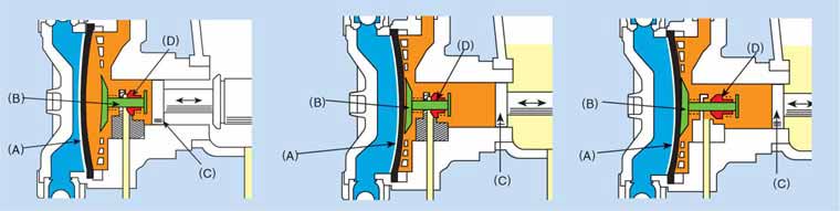

¸ßÐÔÄܸôĤ±ÃÍ·(HPD) £­¼ÆÁ¿±Ã¼¼ÊõµÄ¸ïÃüÐÔ½ø²½
¸ßÐÔÄܸôĤ±ÃͷʹÓÃרÀûMARS¼¼Êõ(×Ô¶¯»úе²¹ÓÍϵͳ)£¬×ÛºÏÁ˸÷Àഫͳ±ÃÍ·µÄÓŵ㡣¸ßÐÔÄÜ
¸ôĤ±ÃÍ·È¡ÏûÁË´«Í³ÒºÑ¹¸ôĤ±ÃÍ·ËùÐèµÄÎïÁ϶˵ÄÔ²Å̸ôĤ»¤ÅÌ£¬´Ó¶øÊ¹±Ã¼È¾ßÓйÜʽ¸ôĤµÄ
¡°Ö±½Óͨ¹ýÐÔ¡±ºÍÖùÈû±ÃµÄµÍNPSH(¾»ÕýÎüÈëѹͷ)ÒªÇóµÈÐÔÄÜ£¬ÓÖÄÜÓÐЧµÄ±£»¤¸ôĤ£¬ÑÓ³¤¸ô
ĤÊÙÃü£¬ÇÒ±ÜÃâÁË´«Í³¼ÆÁ¿±ÃÍ·¾«¶È¿ÉÄÜËæÊ¹ÓÃʱ¼ä±ä»¯µÄÈõµã¡£
MARS¼¼ÊõÔ­Àí£¨×Ô¶¯»úе²¹ÓÍϵͳ£©
¸ôĤ(A)ºÍÖùÈû(C)ѹÏòǰλÖ㬠      ¸ôĤ(A)ºÍÖùÈû(C)ÏòºóÔ˶¯£¬        ¸ôĤ(A)ºÍÖùÈû(C)ÔÙÏòºóÔ˶¯£¬
×Ô¶¯»úе²¹ÓÍ·§(B)ѹÏòǰλÖ㬠    ×Ô¶¯»úе²¹ÓÍ·§(B)Ò²»áÏòºó           ×Ô¶¯»úе²¹ÓÍ·§(B)Ò²ÔÙÏòºóÔË
ÌáÉý·§(D)¹Ø±Õ£¬×èÖ¹²¹Ó͹ÜÄÚ       Ô˶¯Ö±ÖÁÌáÉý·§(D)´ò¿ª¡£Í¼ÖР        ¶¯£¬ÓÉÓÚѹÁ¦½µµÍ£¬ÌáÉý·§(D)
µÄҺѹÓͽøÈëÓÍÇ»                        Ëùʾ£¬ÌáÉý·§(D)¹Ø±Õ¡£±íʾ²»         ´ò¿ª£¬ÔÊÐíҺѹÓÍͨ¹ý¹Ü·½øÈë
                                                Ðè²¹³äҺѹÓÍ                                 ÓÍÇ»

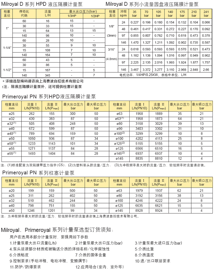

Milroyal ϵÁиßÐÔÄÜҺѹ¸ôĤ¼ÆÁ¿±ÃÁ÷Á¿/ѹÁ¦²ÎÊý±í
Milroyal B ϵÁР                                                ×î´ó³ö¿ÚÁ÷Á¿£º2603L/h£¬×î´ó³ö¿ÚѹÁ¦250barG
