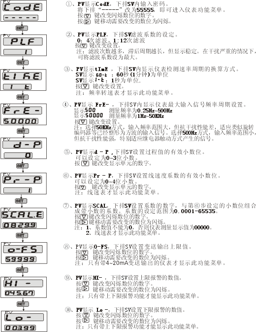

Áù¡¢²Ëµ¥¹¦ÄܲÙ×÷
×¢£º1¡¢Èç¹ûÒÇ±íµ¥ÅÅÊýÂë¹ÜÏÔʾ£¬¼ÌÐø°´SET¼ü£¬¼´¿ÉÏÔʾSVÉ趨ֵ²Ëµ¥¡£
       2¡¢ÓÉÓÚÒÇ±í¹¦Äܲ»Í¬£¬ËùÒÔÓÐЩ²Ëµ¥²»»áÏÔʾ¡£

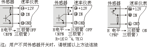

¾Å¡¢ÆµÂÊתËÙ±íÓë´«¸ÐÆ÷¿ª¹ØµÄÁ¬½Ó
