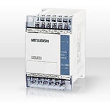

¼òµ¥½éÉÜ
FX1SϵÁÐPLC°ÑÓÅÁ¼µÄÌØµã¶¼ÈںϽøÒ»¸öºÜСµÄ¿ØÖÆÆ÷ÖС£
FX1S
ÊÊÓÃÓÚ×îСµÄ·â×°£¬Ìṩ¶à´ï30¸öI/O£¬²¢ÇÒÄÜͨ¹ý´®ÐÐͨÐÅ´«ÊäÊý¾Ý£¬ËùÒÔËüÄÜÓÃÔÚ½ô´ÕÐÍPLC²»ÄÜÓ¦Óõĵط½¡£
¶¨Î»ºÍÂö³åÊä³ö¹¦ÄÜ
FX1SϵÁÐPLCµ¥Ôª¿ÉÒÔͬʱÊä³ö2µã100KHzÂö³å£¬Å䱸ÓÐ7ÌõÌØÊâµÄ¶¨Î»Ö¸Á°üÀ¨Áã·µ»Ø¡¢¾ø¶ÔλÖöÁ³ö¡¢¾ø¶Ô»òÏà¶ÔµØÖ·±í´ï·½Ê½ÒÔ¼°ÌØÊâÂö³åÊä³ö¿ØÖÆ¡£
ÆäËü¹¦ÄÜ
ÄÚÖÃʽ24VÖ±Á÷µçÔ´
24V¡¢400mAÖ±Á÷µçÔ´¿ÉÓÃÓÚÍâΧÉ豸£¬Èç´«¸ÐÆ÷»òÆäËüÔª¼þ¡£
ʱÖÓ¹¦ÄܺÍСʱ±í¹¦ÄÜ
ÔÚËùÓеÄFX1sPLCÖж¼ÓÐʵʱʱÖÓ±ê×¼¡£Ê±¼äÉèÖúͱȽÏÖ¸ÁîÒ×ÓÚ²Ù×÷¡£Ð¡Ê±±í¹¦ÄܶԹý³Ì¸ú×ٺͻúÆ÷ά»¤ÌṩÁËÓмÛÖµµÄÐÅÏ¢¡£
³ÖÐøÉ¨Ã蹦ÄÜ
ΪӦÓÃËùÐèÇóµÄ³ÖÐøÉ¨Ãèʱ¼ä¶¨Òå²Ù×÷ÖÜÆÚ¡£
ÊäÈëÂ˲¨Æ÷µ÷½Ú¹¦ÄÜ
¿ÉÒÔÓÃÊäÈëÂ˲¨Æ÷ƽÕûÊäÈëÐźţ¨ÔÚ»ù±¾µ¥ÔªÖÐx000µ½x017£©¡£
Ôª¼þ×¢½â¼Ç¼¹¦ÄÜ
Ôª¼þ×¢½â¿ÉÒԼǼÔÚ³ÌÐò¼Ä´æÆ÷ÖС£
ÔÚÏß³ÌÐò±à¼­
ÔÚÏ߸ıä³ÌÐò²»»áËðʧ¹¤×÷ʱ¼ä»òÍ£Ö¹Éú²úÔËת¡£
RUN/STOP ¿ª¹Ø
Ãæ°åÉÏÔËÐÐ/Í£Ö¹¿ª¹ØÒ×ÓÚ²Ù×÷¡£
Ô¶³Ìά»¤
Ô¶´¦µÄ±à³ÌÈí¼þ¿ÉÒÔͨ¹ýµ÷ÖÆ½âµ÷Æ÷ͨÐÅÀ´¼à²â¡¢ÉÏÔØ»òÐ¶ÔØ³ÌÐòºÍÊý¾Ý
ÃÜÂë±£»¤
ʹÓÃÒ»¸ö°ËλÊý×ÖÃÜÂë±£»¤ÄúµÄ³ÌÐò¡£
½»Á÷µçÔ´¡¢24VÖ±Á÷ÊäÈëÀàÐÍ
Ä£ÐÍ
I/O×ÜÊý
ÊäÈë
Êä³ö
³ß´ç
mm£¨Ó¢´ç£©
£¨¿í£©£ª£¨ºñ£©£ª£¨¸ß£©
ÊýÄ¿
ÀàÐÍ
ÊýÄ¿
ÀàÐÍ
FX1s-10MR-001
10
6
©ÐÍ
4
¼ÌµçÆ÷
60£ª75£ª90
£¨2.4£ª3.0£ª3.5£©
FX1s-10MT
¾§Ìå¹Ü
FX1s-14MR-001
14
8
©ÐÍ
6
¼ÌµçÆ÷
60£ª75£ª90
£¨2.4£ª3.0£ª3.5£©
FX1s-14MT
¾§Ìå¹Ü
FX1s-20MR-001
20
12
©ÐÍ
8
¼ÌµçÆ÷
75£ª75£ª90
£¨£© 3.0£ª3.0£ª3.5
FX1s-20MT
¾§Ìå¹Ü
FX1s-30MR-001
30
16
©ÐÍ
14
¼ÌµçÆ÷
100£ª75£ª90
£¨3.0£ª3.0£ª3.5£©
FX1s-30MT
¾§Ìå¹Ü
X1sÐÔÄܹæ¸ñ
씀
¹æ¸ñ
ÔËת¿ØÖÆ·½Ê½
ͨ¹ý´¢´æµÄ³ÌÐòÖÜÆÚÔËת
I/O¿ØÖÆ·½·¨
Åú´Î´¦Àí·½·¨£¨µ±Ö´ÐÐENDÖ¸Áîʱ£©
I/OÖ¸Áî¿ÉÒÔË¢ÐÂ
ÔËת´¦Àíʱ¼ä
»ù±¾Ö¸Á0.55ÖÁ0.7?s
Ó¦ÓÃÖ¸Á3.7ÖÁ¼¸°Ù?s
±à³ÌÓïÑÔ
Âß¼­ÌÝÐÎͼºÍÖ¸ÁîÇåµ¥
ʹÓò½½øÌÝÐÎͼÄÜÉú³ÉSFCÀàÐͳÌÐò
³ÌʽÈÝÁ¿
ÄÚÖÃ2K²½EEPROM
´æ´¢ºÐ£¨FX1n-EEPROM-8L£©¿ÉÑ¡
Ö¸ÁîÊýÄ¿
»ù±¾Ë³ÐòÖ¸Á27
²½½øÌÝÐÎÖ¸Á
2
Ó¦ÓÃÖ¸Á85
×î´ó¿ÉÓÃ167ÌõÓ¦ÓÃÖ¸Á°üÀ¨ËùÓеı仯
I/OÅäÖÃ
×î´ó×ÜI/OÓÉÖ÷´¦Àíµ¥ÔªÉèÖÃ
¸¨Öú¼ÌµçÆ÷
£¨MÏßȦ£©
Ò»°ã
384µã
M0ÖÁM383
Ëø¶¨
128µã£¨×Óϵͳ£©
M384ÖÁM511
ÌØÊâ
256µã
M8000ÖÁM8255
״̬¼ÌµçÆ÷
£¨SÏßȦ£©
Ò»°ã
128µã
S0ÖÁS127
³õʼ
10µã£¨×Óϵͳ£©
S0ÖÁS9
¶¨Ê±Æ÷£¨T£©
100ºÁÃë
·¶Î§£º0ÖÁ3276.7Ãë63µã
T0ÖÁT55
10ºÁÃë
·¶Î§£º0ÖÁ327.67Ãë31µã
µ±ÌØÊâMÏßȦ¹¤×÷ʱT32ÖÁT62
1ºÁÃë
·¶Î§£º0.001ÖÁ32.767Ãë1µã
T63
¼ÆÊýÆ÷£¨C£©
Ò»°ã
·¶Î§£º1ÖÁ32767Êý16µã
C0ÖÁC15
ÀàÐÍ£º16λÔö¼ÆÊýÆ÷
Ëø¶¨
C16ÖÁC31
ÀàÐÍ£º16λÔö¼ÆÊýÆ÷
¸ßËÙ¼ÆÊýÆ÷
£¨C£©
µ¥Ïà
·¶Î§£º-2147483648ÖÁ+2147483647Êý
FX0
£ºÑ¡Ôñ¶à´ï4¸öµ¥Ïà¼ÆÊýÆ÷£¬×éºÏ¼ÆÊýÆ÷ƵÂʲ»´óÓÚ2KHz¡£
FX0s
£ºµ±Ê¹Óöà¸öµ¥Ïà¼ÆÊýÆ÷ʱ£¬ÆµÂʺͱØÐë²»´óÓÚ14KHz¡£Ö»ÔÊÐíµ¥¡¢Ë«Ïà¸ßËÙ¼ÆÊýÆ÷ͬʱʹÓᣵ±Ê¹ÓÃË«Ïà¼ÆÊýÆ÷ʱ£¬×î´ó¼ÇÊýËٶȱØÐë´óÓÚ14KHz£¬¼ÆËãΪ£¨¼ÇÊý±ßÊýΪ5ʱ£¬2ph¼ÆÊýÆ÷ËÙ¶È£©+1ph¼ÆÊýÆ÷ËÙ¶È¡£
C235ÖÁC238
4
µã£¨×¢ÒâC235±»Ëø¶¨£©
µ¥Ïàc/wÆðʼ
Í£Ö¹ÊäÈë
C241£¨Ëø¶¨£©¡¢C242ºÍC244£¨Ëø¶¨£©3µã
Ë«Ïà
C246¡¢C247ºÍC249£¨¶¼Ëø¶¨£©3µã
A/BÏà
C251¡¢C252ºÍC254£¨¶¼Ëø¶¨£©3µã
Êý¾Ý¼Ä´æÆ÷
£¨D£©
Ò»°ã
128µã
D0ÖÁD127
ÀàÐÍ£º32λԪ¼þµÄ16λÊý¾Ý´æ´¢¼Ä´æÆ÷¶Ô
Ëø¶¨
128µã
D128ÖÁD255
Íⲿµ÷½Ú
·¶Î§£º0ÖÁ255 2µã
ͨ¹ýÍⲿÉèÖõçλ¼Æ¼ä½ÓÊäÈëD8013»òD8030&D803114Êý¾Ý
ÌØÊâ
256µã£¨°üº¬D8030£¬D8031£©
´ÓD8000ÖÁD8255
ÀàÐÍ£º16λÊý¾Ý´æ´¢¼Ä´æÆ÷
±äÖ·
16µã
VºÍZ
Ö¸±ê
£¨P£©
ÓÃÓÚCALL
64µã
P0ÖÁP64
ÓÃÓÚÖжÏ
6µã
100£ªÖÁ130£ª
£¨ÉÏÉý´¥·¢£ª=1£¬Ï½µ´¥·¢£ª=0£©
ǶÌײã´Î
ÓÃÓÚMCºÍMRCʱ8µã
N0ÖÁN7
³£Êý
Ê®½øÎ»K
16λ£º-32768ÖÁ+32768
32
λ£º-2147483648ÖÁ+2147483647
Ê®Áù½øÎ»H
16λ£º0000ÖÁFFFF
32
λ£º00000000ÖÁFFFFFFFF
