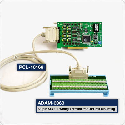

16룬8··Ç¸ôÀëÄ£ÄâÁ¿Êä³ö¿¨
Main Features
×Ô¶¯Ð£×¼¹¦ÄÜ
ÿ¸öÄ£ÄâÁ¿Êä³öͨµÀ´øÒ»¸ö16λDAC
ͬ²½Êä³ö¹¦ÄÜ
ÏµÍ³ÖØÐÂÈÈÆô¶¯ºó±£³ÖÊä³öÖµ
2¶Ë£¨16·£©Óû§¶¨ÒåÊý×ÖÁ¿ÊäÈë/Êä³ö
°å¿¨ID
Êý¾Ý±í(PDF)
Free Download WaveScan
¼¼Êõ×ÊÁÏÏÂÔØ
²úÆ·½éÉÜ
PCI-1723ÊÇÒ»¿î·Ç¸ôÀëµÄ¶àͨµÀPCIÄ£ÄâÁ¿Êä³ö¿¨£¬Ã¿¸öÄ£ÄâÁ¿Êä³öͨµÀ¶¼´øÓÐÒ»¸ö16λµÄË«»º³åDAC¡£´ËÊä³ö¿¨¾ßÓÐ×Ô¶¯Ð£×¼¹¦ÄܺͰ忨IDµÈ¡£PCI-1723ÊÇÒªÇó¶à·ģÄâÁ¿Êä³öÓ¦ÓõÄÀíÏëÑ¡Ôñ¡£

PCI-1723-AE
16bit, 8ch Synchronized Analog Output Card
ÔÚÏß¹ºÂò
Õû»ú×é×°
¸½¼þ
²úÆ·ÃèÊö
ADAM-3968-AE
SCSI-68 Wiring Terminal, DIN-rail Mount
PCL-10168-1E
SCSI-68 Shielded Cable, 1m
PCL-10168-2E
SCSI-68 Shielded Cable, 2m
