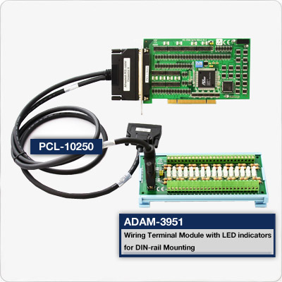

Main Features
  • 64·¸ôÀëÊý×ÖÁ¿Êä³ö
  • Êä³öͨµÀ¸ßµçѹ¸ôÀ루2500VDC£©
  • 2000VDC ESD±£»¤
  • ¿íÊäÈ뷶Χ£¨5~40VDC£©
  • ¸ôÀëÊä³öͨµÀÉϵĸ߻ãµãµçÁ÷£¨×î´ó200 mA/ÿͨµÀ£©
  • Êä³ö״̬»Ø¶Á
  • ÈÈÖØÆô¶¯ÏµÍ³Ê±±£³ÖÊý×ÖÁ¿Êä³öÖµ
  • ͨµÀ¶³½á¹¦ÄÜ
  • ¸ß¶È¼¯³ÉµÄ100-pin SCSI ½Ó¿Ú

PCI-1752UÄܹ»Ìṩ¸ôÀëÊý×ÖÁ¿ÊäÈëͨµÀºÍ¸ôÀëÊý×ÖÁ¿Êä³öͨµÀ,¸ôÀë±£»¤µçѹ¿É´ïµ½2500VDC¡£ËûÃÇÊÇÒªÇó²ÉÈ¡¸ßµçѹ¸ôÀ빤ҵӦÓõÄÀíÏëÑ¡Ôñ¡£´ËÍâ,ËùÓÐÊä³öͨµÀÔÚÏµÍ³ÖØÆôºó¶¼¿ÉÒÔ±£³ÖËüÃÇÉϴεÄÊä³öÖµ£¬Í¬Ê±PCI-1752UÌṩͨµÀ¶³½á¹¦ÄÜ,ÔÚ²Ù×÷¹¤×÷ÖпÉÒÔ½«Ã¿¸öͨµÀµÄµ±Ç°Êä³ö״̬ά³Ö²»±ä¡£
Specifications
  PCI-1752U-AE
Advanced Function BoardID Switch V
General Connectors 100-pin SCSI-II
Isolated DI/O Input Channels N/A
Input Range N/A
Input<br />Isoloation Voltage N/A
Output Channels 64 (Sink)
Output Max.Sink Current 200mA
Output Range 5 ~ 40 VDC
Output<br />Isoloation Voltage 2500 VDC

  PCI-1752U-AE
RoHS
64ch Isolated Digital Output Card (Sink)
¸½¼þ
²úÆ·ÃèÊö
  ADAM-3951-BE  Screw-Terminal Board with LED indicator
  PCL-10250-1E  SCSI-100 to 2*SCSI-50 Shielded Cable, 1m
