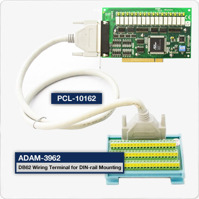

PCI-1762 8·¼ÌµçÆ÷Êä³öºÍ8·¸ôÀëÊý×ÖÁ¿ÊäÈë
Main Features
  • ÌøÏßÑ¡ÔñAÐÍ/BÐͼ̵çÆ÷Êä³öͨµÀ
  • Êä³ö״̬»Ø¶Á
  • ÈÈÖØÆôϵͳʱ±£³Ö¼ÌµçÆ÷Êä³öÖµ
  • ÊäÈëͨµÀ¸ßѹµç¸ôÀ루2,500V DC£©
Êý¾Ý±í(PDF) Free Download WaveScan ¼¼Êõ×ÊÁÏÏÂÔØ
²úÆ·½éÉÜ
PCI-1762ÊÇÒ»¿îPCI×ÜÏߵļ̵çÆ÷Êä³ö¼°¸ôÀëÊý×ÖÁ¿ÊäÈë°å¿¨.ËüÌṩ8·¹â¸ôÀëÊý×ÖÁ¿ÊäÈëͨµÀ,¸ôÀë±£»¤µçѹΪ2500VDC,¿ÉÔÚÔëÉù»·¾³ÏÂÊäÈë.Ëü´øÓÐ8¸ö¼ÌµçÆ÷Êä³ö,¿ÉÒÔÓÃ×÷¿ª¹Ø¿ØÖÆÊ½Ð¡Ð͵çÔ´¶Ï·¿ª¹Ø.ΪÁ˱ãÓÚ¼à¿Ø,ÿ¸ö¼ÌµçÆ÷¶¼ÅäÓÐÒ»¸öºìÉ«µÄLEDָʾµÆ,ÓÃÀ´ÏÔʾÆ÷¿ª/¹Ø×´Ì¬.PCI-1761µÄ8·¹â¸ôÀëÊäÈëͨµÀÊÇÔëÉù»·¾³»òµçÎ»Æ¯ÒÆÏÂÊý×ÖÊäÈëµÄÀíÏëÑ¡Ôñ
Specifications
  PCI-1761-AE
Advanced Function BoardID Switch V
General Connectors 1 x DB-37
Isolated DI/O Input Channels 8 (Sink)
Input Range 10 ~ 50 VDC
Input<br />Isoloation Voltage 2,500 VDC
Output Channels 4 x Form A
4 x Form C
Output Max.Sink Current 250 VDC @ 3 A
24 VDC @ 3 A
Output Range 250 VDC @ 3 A
24 VDC @ 3 A
Output<br />Isoloation Voltage 2500 VDC

  ADAM-3962-AE  DB-62 Wiring Terminal, DIN-rail Mount
  PCL-10162-1E  DB-62 Shielded Cable, 1m
  PCL-10162-3E  DB-62 Shielded Cable, 3m
